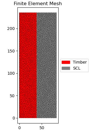

what exactly did you model with sectionproperties?

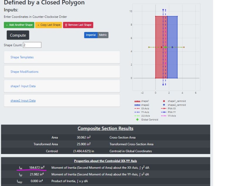

If you put both sections into a section analysis software and include the difference in E in that analysis, it should provide a fully composite result based on the transformed section properties.
Here is an example:
Assumptions:
2.0E Weyerhaeuser for the LVL
Elvl = 2,000 ksi
Fblvl = 2.6 ksi
Ixxlvl = 115.42 in4
No.2 SPF 2x10
E210 = 1,400 ksi
Fb210 = 0.875 ksi
Ixx210 = 98.932 in4
Transformed Ixx, assuming Elvl as the basis:
Ixxcomposite = 184.672 in4
Ecomposite = 2,000 ksi
Deflection Formula for a simply supported uniform loaded beam:
delta = (5*w*L4*1728) / (384*E*I) = (22.5*w*L4) / (E*I)
EIcomposite = 369,344 k*in2
delta = 6.09188e-5 *w*L4
Load distributed based on member stiffness:
∑ EI = 369,344
EIlvl/∑ EI = 0.625
EI210/∑ EI = 0.375
deltalvl = 0.625*22.5*w*L4 / EIlvl = 6.09188e-5 *w*L4
delta210 = 0.375*22.5*w*L4 / EI210 = 6.09188e-5 *w*L4

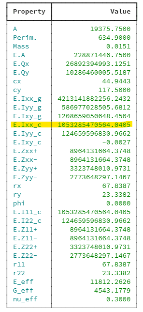

See screenshot below:
2x10:
E = 9500MPa
1-3/4"x9-1/4" 2.0E LVL:
E = 13789MPa
When I run the 5*w*l^4/384EI equation with the EI in the screenshot under the same loading as when I did the original approach to split the loading based on stiffness to match deflection, I get a much larger deflection when using the composite EI.
