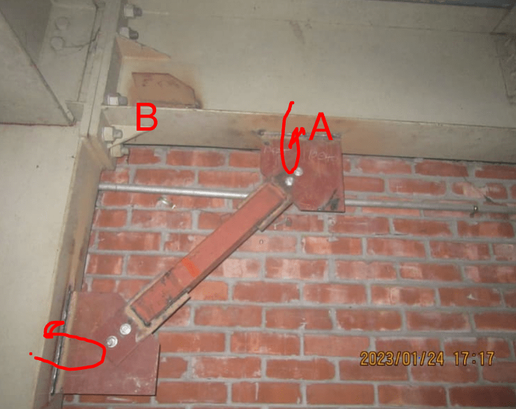

Dear Engineers,
I have attached a figure herewith which will be beneficial in understanding my query.
As you can see, the steel building is three-storied, and some knee braces were added previously to avoid retrofitting of some main steel beams (girders). The purpose was to reduce the length of the member and produce less loads in the girder, which was achieved well.
However, the knee braces' connections are not capable to resist the loads transferred to them in ETABS.
Two bolts can carry about 24.8 kips of shear load.
Whereas in FEM (ETABS) we get a force of about 45 kips due to gravity load combos. Also in some gravity+lateral load combos, the applied load exceeds the capacity of the connection.
Is there any method by which we can declare that these knee braces are provided just to carry say 20 kips forces and the latter forces are not intended for it, equilibrium will be established for the whole structure considering this trade-off (knee braces taking only 20 kips).
Is this justifiable??
This is an existing building, we don't want to apply weld and ignore those bolts to carry the applied loads, because it will be massive work and the factory is in operation.
Thanks....

I think I would check buckling and other stuffs and find stiffness of the connection and assign it in the model to attract loads suitably.
From this obtained load, i would deduct the dead load, on LL apply LLRF and finally calculate the load and check against connection capacity.

In this example it is a relatively simple to back calculate the required deflection that the beam must undergo to limit the load on the knee brace to 20kips. If that deflection is 0.1mm (unlikely) you are going to be fine.
If the calculated deflection is beyond the plastic or buckling STRAIN limit of the connection then the connection would be expected to fail.
It looks like in the photo that you could weld the plate to the gusset, thereby no longer requiring the bolts. Is there a reason welds can't be added to remove the bolts being the failure mechanism?

This is the sort of retrofit detail where I can see someone doing an analysis and:
1. Seeing a moment overage, and designing for that without seeing the vertical load path
2. Seeing a need for lateral capacity and not seeing the vertical load path
3. Seeing an overage and designing for the overage only without evaluating the stiffness change or realizing that load sharing doesn't necessarily work like that
That being said, depending on the stiffnesses of things, there might be some argument that the relative stiffnesses will bias loads away from the brace.
1. As discussed, the dead load was already applied
2. The stiffness of the already loaded moment connection is going to be higher than the brace. It needs to move to take up the bolt hole slop before it even starts to load. That close to the support point, this amount of movement actually may be a reasonable amount of load
That being said, it seems like this reinforcement won't do much until you get pretty high up on the stress range for the structure. So I suspect you can't say much about proving it with existing service history.
You can make lots of judgements, but I question how solidly you'll feel relying on them given the fact that you can't rely on load history very much.
The easiest thing to do would be to slip bolts out one at a time and replace them with stronger bolts. But knowing the behaviour when you take one bolt out is going to be tricky given how badly the numbers do just based on gravity, so I'm not sure that's even a good idea.

TLHS, your load path discussion was enlightening for me, thanks. The original intention of putting the brace below was to lower bending demand in the rigidly connected beam.
Anyway, I think I'll go for welding.

Unless I'm mistaken, the knee brace member here is flat strap. Granted, I do have pretty serious presbyopia these days. If that's correct, then I would offer the following, dissenting opinion:
1) No way in hell these were ever installed with the intent of assisting the girders.
2) I highly suspect that the knee braces were intended to serve as tension only, lateral load resisting elements.
3) Ideally, the flat strap would buckle out of the way before the overloading the bolts in compression (gravity or lateral induced).
To the extent that I'm correct about this, you may well be able to cap the amount of force received by the bolts well below that which would be predicted by your ETABS model.
Koot, I'm pretty sure those are square HSS with a knife plate.
This is an imperfect analog but, conceptually, tension only knee bracing is a bit like Flexible Moment Connections which are also intended to meaningfully engage only under the action of lateral loads: Link.
Frankly, I detest both knee braces and FMC and try mightily hard to avoid both in the context of new builds. But, alas, I'm not the boss of the world so this stuff must be accommodated sometimes. I table this simply to point out that there is precedent for such things.
Clearly, the bolts have not been overloaded by beam shear yet. That's something, particularly given that prying action from the girder would develop monstrous forces in an unbuckled brace in a wicked hurry.
There's definitely some thickness there. I'd considered either:
1) Two straps with a spacer to facilitate symmetry.
2) A rather narrow HSS.
Either way, the same thing may apply. Granted, even a narrow HSS will have significant axial capacity over such a short length.
Additional observations:
1) The girder to column connection here is obviously a moment connection of some stiffness. So point is a location of minimal beam slope. That, as opposed to it being a point of maximal beam slope as would be the case for a simply supported beam.
2) The brace only absorbs connection in proportion to how much point [A] moves downward. Given the scale of the girder, and the presence of the moment connection, I'm guess that deformation is pretty small.
3) Given the scale of the girder to column moment connection, it's hard to imagine that the braces would do anything meaningful for lateral loads, even if they were adequately designed for the anticipated compression.
4) The brace gussets are horribly eccentric. My money would be on them rolling over long before the brace was fully mobilized for anything usefull in compression.
SUMMARY: I'd be treating this connection as though the brace wasn't even there.
