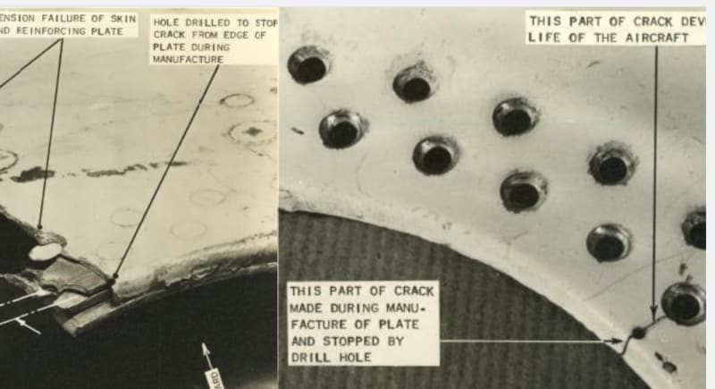

By the way, little advertised fact is that the structure recovered from the accident aircraft had stopped drilled cracks in numerous areas around the adf cutouts. The stopped drill cracks where a result of the punch drilling opertion dehavilland employed on the early produced aircraft. It is discussed in the public hearings but was written off as standard practice. Note the subsequent full scale fatigue test by RAE did not replicate the failures at the ADF cutouts in the crown of the fuselage but instead showed failures at the cabin windows and the test article did not have any stopped drilled cracks. The punch drilling operation induced damage in the holed thru "ripping" of the material.
If you search online, I presented a paper at AAS 2017 which shows the stop drilled cracks and also presented some of it at ASIP 2021, you might be able to find the papers online. Also, Dr Paul Withey has presented several papers on this topic and confirmed the presence of damage in the original panel at the ADF cutouts. Not to say high stresses were not significant, which they obviously were, but if you include at least 4 or more stopped drilled cracks in the same area, the stresses would be even higher.

found a quick snapshot from the accident report.
"punch drilling" is probably like cutting a lightening hole, particularly if you're dimpling the skin (like the flange of the lightening hole).
