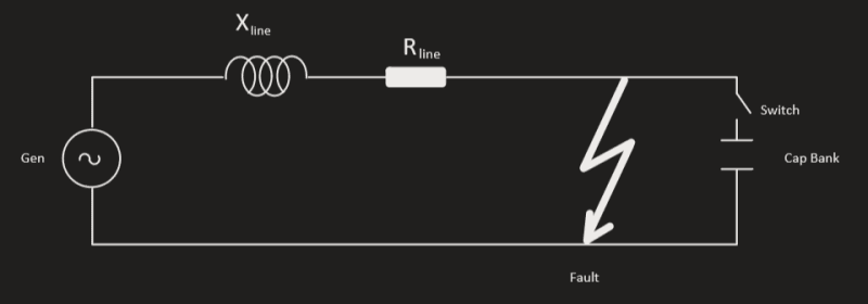

Hi fellas, thank you for the posts you have put up. I now understand that with the cap bank in the network, with the L, R & C switching in and out, this would cause significant transient to the network at high frequencies depending on f=1/√LC. What if in a situation where the cap bank is already switched in at steady state condition, and a fault should occur as in the picture below:
Would both the generation source and cap bank be feeding into the fault. How would the sub-transient fault current look like at the generator protection & the cap bank protection side? What's the influence of fault time on the contribution to the total fault current from the generator & cap bank?

A difference of a series capacitor, a shunt capacitor bank contributes very little to the short circuit currents.
However, high frequency in the kHz range caused by the capacitor outrush current component could impact the yard protective devices transient TRV rating during short line fault (SLF).
Special consideration should be observed in the case of reignition to avoid exceeding the circuit breakers duty rating particularly for old breakers classified as a general-purpose either SF6 or more carefully for oil-filled type.
