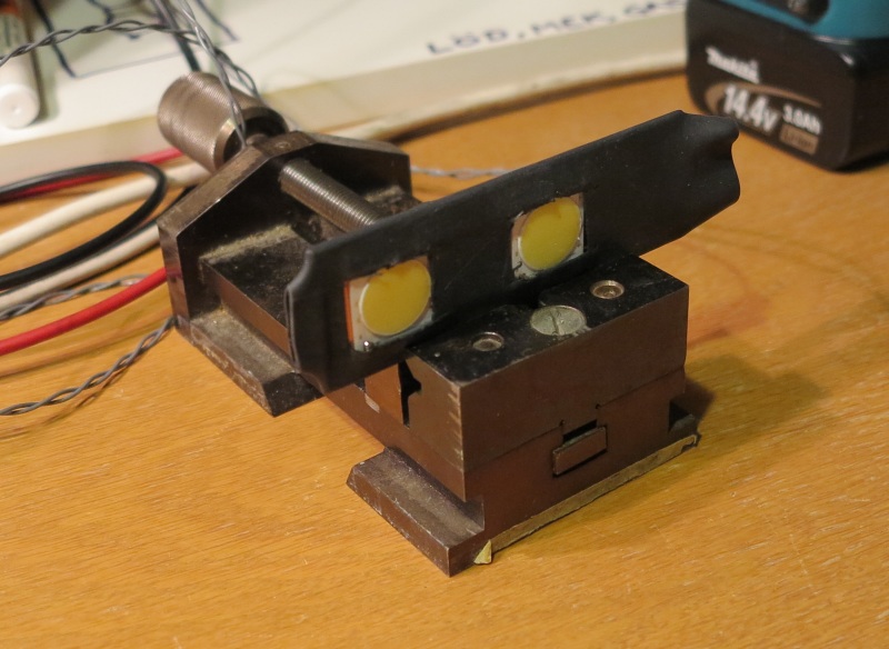

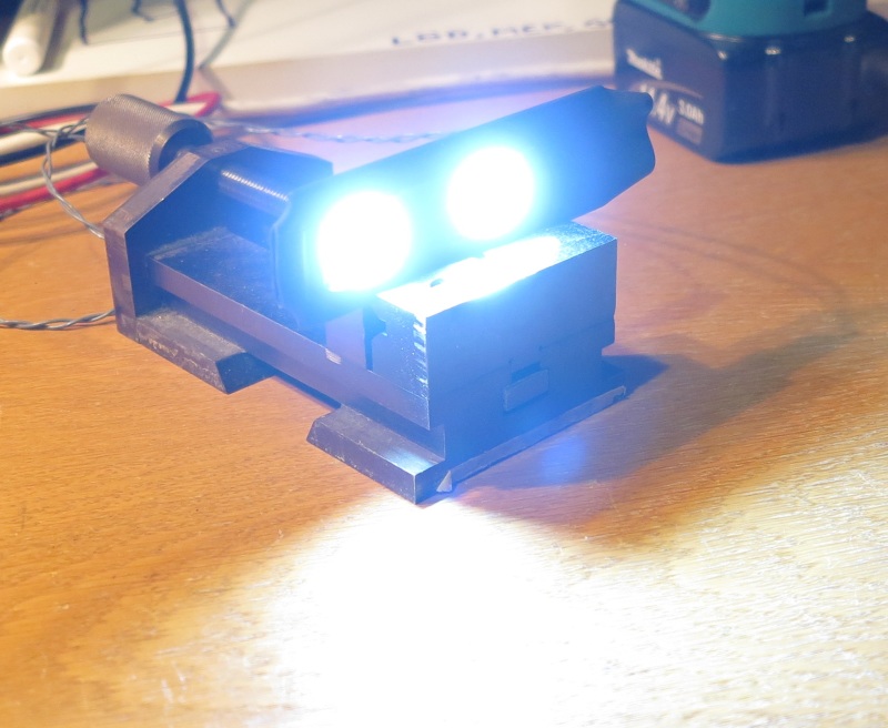

Tests with a stroboscope didn't reveal much. Too bleak light. I have now put super bright LEDs (COB 2024) on a heat sink and protect them with some shrink tubing. See pictures below (dark):
And light:
I can set pulse width from around 20 us to 500 us and pick up the trig signal from the shaft. So, we should get a stationary view at all speeds. The ventilation fans are 7.5 + 7.5 kW and the air flow is said to be very high - I think around 1200 m3/minute. Hard to believe. But that is the number I have heard. So Mike's thinking seems to be plausible.
Results will be available in around one week. Stay tuned!

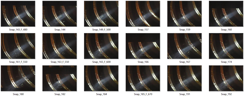

Today's results
We had another go at the risers today. Armed with a very intense strobe light that was synchronized to the motor shaft using a NeB magnet and a reed relay mounted on a magnet stand, we had high hopes to be able to see variations in the distance between the risers. The strobe pulses were 50 microseconds (a standard Xenon strobe has around 20 us) and the reed element closes in less than 100 us with an estimated maximum spread +/-20 us. The resulting uncertainty in riser position from frame to frame is between 0.3 and 0.5 mm tangential. There seems to be some vibrations in the magnet stand and they come and go at certain speeds. A more stable stand was not available, but those frames where the influence from the stand is obvious have been deleted. The results are shown in pictures below (snap number plus an F indicating fan on and a number giving approximate RPM).
Comments invited.
