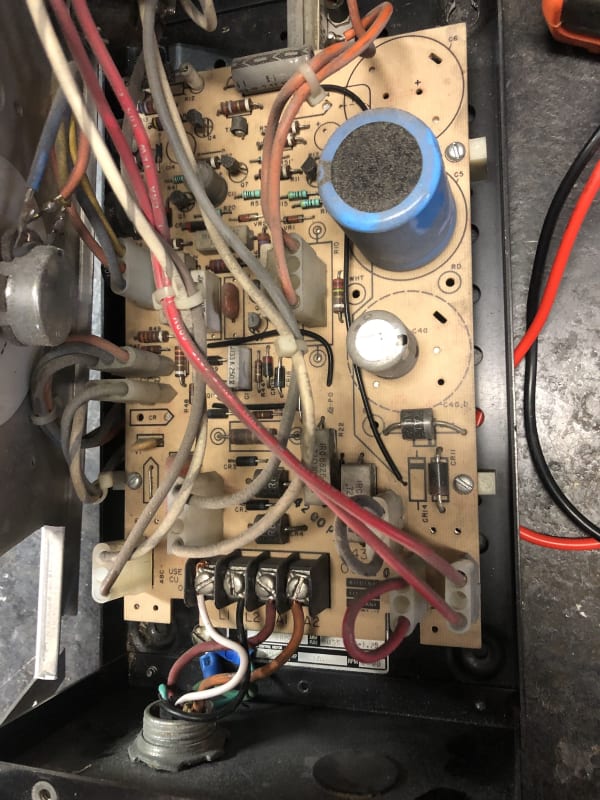

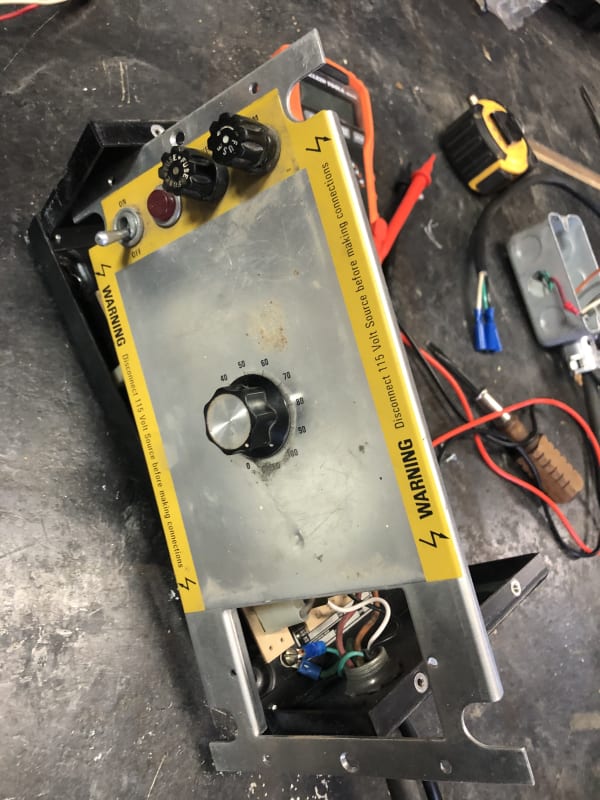

I have this DC motor, can anyone tell me how to see if its good, I hooked it up to a 9V battery works both directions. I hook it up to the controller and it wont start without a bump. Controller is reading 65V on each leg. Dont know if thats correct or should it be reading 120V on each leg. Thanks
Its the controller that it came with, I checked the voltage at where its marked A1-A2 beside the L1-L2.
Just checked the Potentiometer, reads 407 Ohms to 0 Ohms seems to be working.
But it doesnt change the DC voltage at the A1-A2
A1,A2 are usually the terminal numbers for a contactor, so this controller may have been intended to work in conjunction with a contactor in series with the DC output. DC terminals are usually just marked + and -, but I don’t see any in that photo. There appear to be some wires going out of the top of the 2nd photo, what do they go to?
No other wires its all contained once assembled.
Only wires coming out are the A1-A2 and the 110 black and white.
If your 110 V connection is AC (typical output from a wall outlet, for example), then part of the controller is a rectifier to "create" the required DC input to the motor at A1-A2. For most DC machines, the nameplate voltage (in your case, 130), refers to the total difference between A1-A2. Note that this could appear as 130-to-0 (if one leg is tied to ground), or "plus 65"-to-"minus 65" because the neutral plane is somewhere in the middle. It could even be 14065-to-13935, if the "neutral" plane is up around 14 kV.
To start turning, the applied A1-A2 voltage has to exceed the back EMF voltage of the armature circuit. In the case of a gear motor like this, it also has to be enough to cover the voltage drop across the field (if it's electro-magnetic and not rare earth materials). And it has to produce enough torque to overcome the friction of the system (bearings, gears, etc.). If the motor spins up on a 9 V battery, there isn't a lot of back EMF, nor is there an electro-magnet main field.

I hesitate to disagree with my friend jraef. However I have seen quite a few DC motors marked A1, A2. Armature 1, Armature 2, to differentiate from F1 and F2. (Field 1 and you know the rest.)
(That was motor markings, not controller markings.)
How old is that equipment?
115 Volts hasn't been a standard voltage since the early 1950s. (But no everyone got the memo.)
The controller may have a failing capacitor. (Big blue cylinder)
