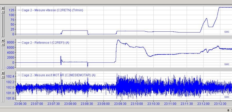

You can see thereafter some curves. The first show the current reference for stand 4 (it's for the stand, so for each motor, it must be divided per 2). The second show the voltage for each motor. The third show field current for each motor. The last show the motors speed in RPM)
My question : how could armature's current could have an effect on field's current (I know the effect on field's flux) ?
panter
Yup, the red field current is unsteady and drops even at steady armature current after 09.09.30 mark while the blue field current is pretty much constant through out the cycle.
Also, the speed (4) is pretty much tracking the armature voltage (2) and the 'spikes' in red field current seem to have no effect on the speed, which is counter intuitive.
May be the red field current measurement sensor is picking up lot of noise?

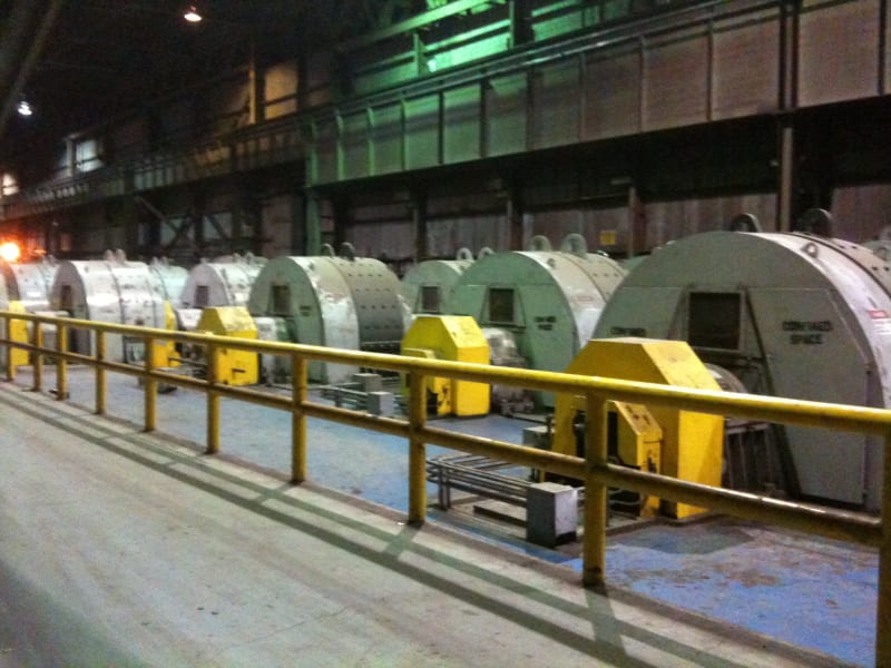

Sometimes it's helpful to have a "visual" in describing a topic.
These are Westinghouse Direct Current motors in a hot strip mill with similar specs provided by the OP.
These massive machines do have failures from time-to-time... but not ALL of them fail at the same time.
I can "see" a scenario where if one machine had a repair during its service life that changed its electrical
characteristics ever so slightly.... that change (a turn left off on a field winding etc.) or
whatever... the change could impart or show up on a computer generated screen graph.
Man. Good luck chasing the real cause.

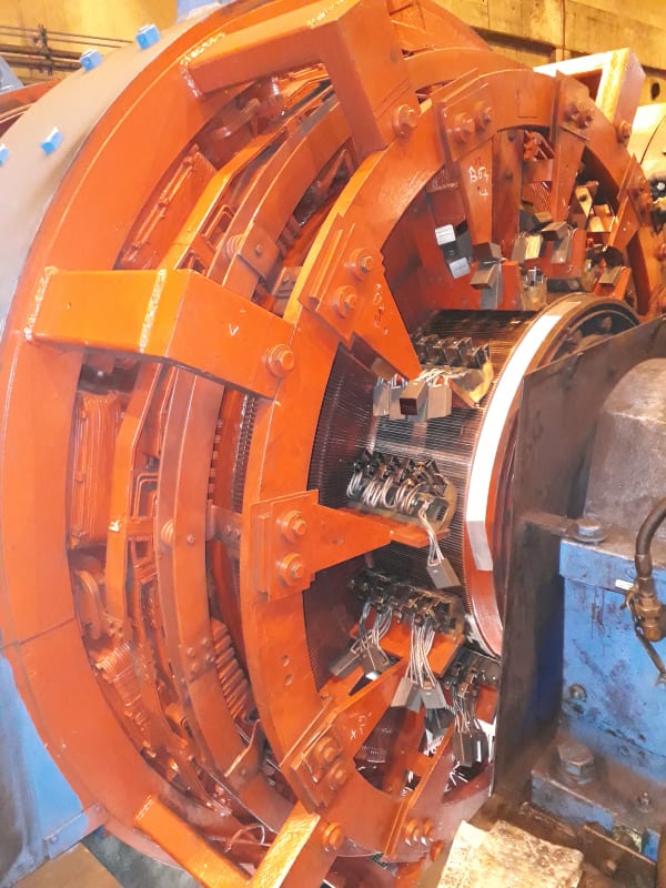

You can see hereafter a commutator during the setting of neutral.
I will make some photos of the motors tomorow.

John, I'm a little bit puzzled : before grinding a commutator, the amplitude of oscillations is big and just after, the amplitude is low. I don't make the connection between that and a power supply issue ? Have you got an idea ?

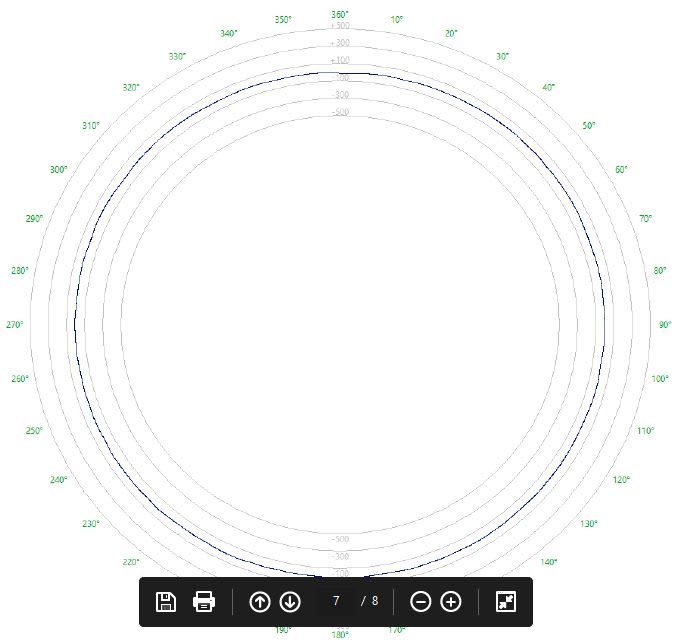

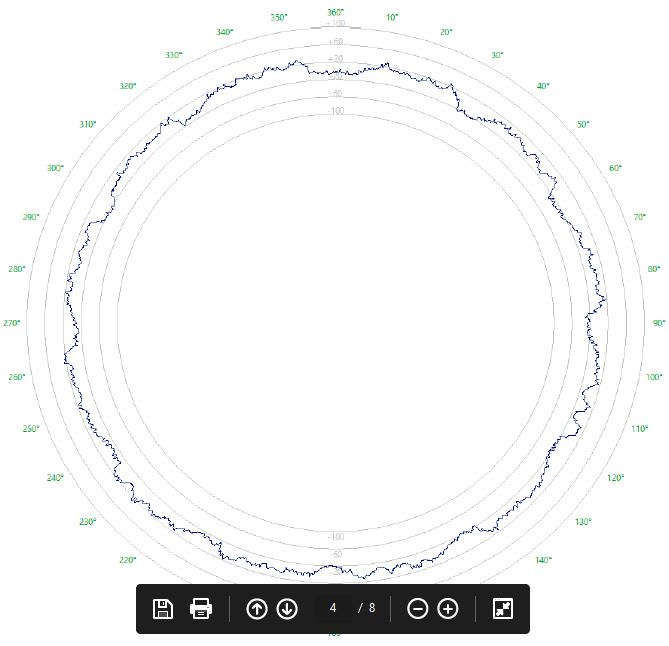

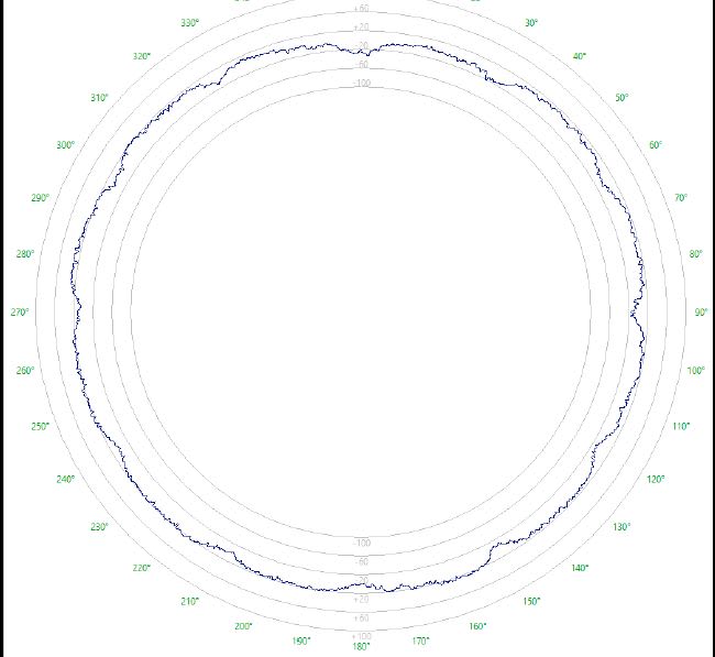

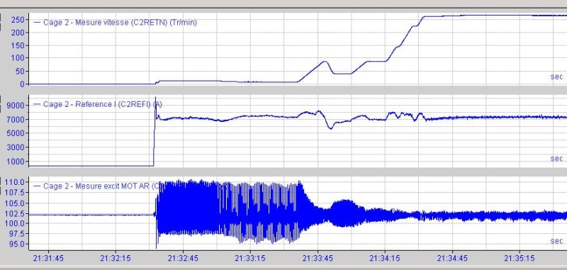

Below, oscillations before grinding, then after grinding (May 5, 2020 - Stand 2, rear motor).
Speed, armature current are quite comparable. But the amplitude of oscillations goes from 15A to 0,7A.
Below these 2 records, you can see the surface of commutator before (2 pictures, near the edge and in the middle of commutator) and after grinding (1 picture).
