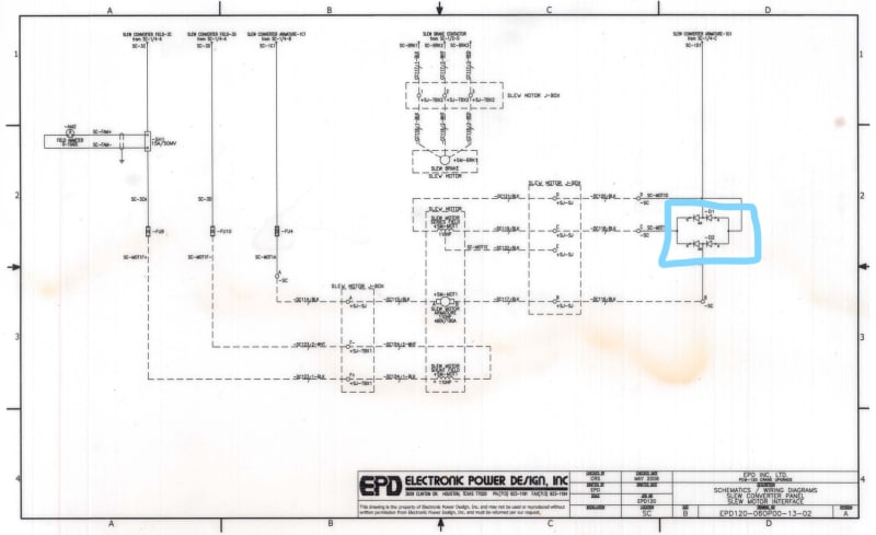

Please see below a DC compound motor control schematic.
What is the function of set of 4 diodes on the right (marked in blue) that feed the series field?
Are they for ensuring the series field current direction is unidirectional when armature voltage is reversed for rotation direction reversal (hoist up/down)?
How do they work? Thanks for your inputs.

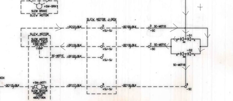

Diodes keep same current direction on series field when motor voltage polarity is reversed (motor direction change).
So, series field remain in same direction and avoid high voltage development at current reversal also.
Thanks, Bill and iop.
I am trying to visualize the current flow path via the diodes for both positive polarity and negative polarity and am stuck.
Muthu
I recommend using colored pencils/pens/computer markups. Pick a color. Mark one side + and the other side -. Trace current paths from + to -. Pick a different color and reverse the polarity marks. Trace current paths from + to - again.

The interpoles are always in series with the armature.
The purpose of the interpoles is to mitigate the distortion of the magnetic flux in the air gap caused by the armature.
The purpose of the series field is to strengthen the shunt field.
If the current in the series field reversed when the armature current reversed, the series field would weaken the shunt field rather than strengthen it.
Hence the bridge diode so that the series field remains the same polarity as the shunt field.
Note that the diodes must carry full armature current.

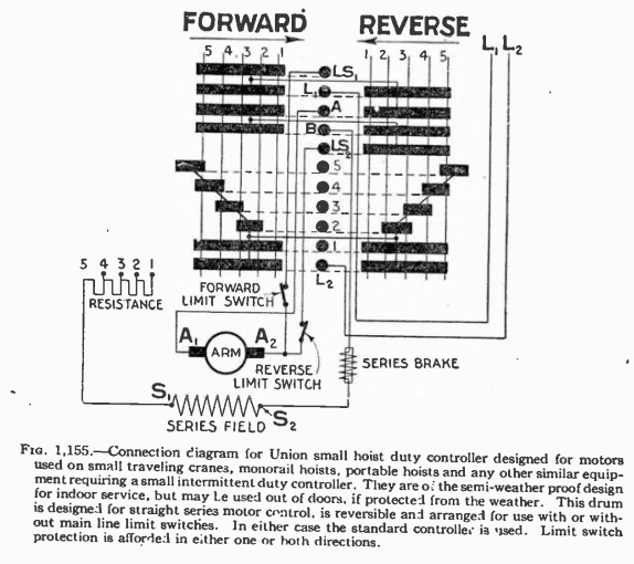

I support the idea that the diodes are intended to keep the field pointed in one direction when the armature is reversed, so that torque and rotation will reverse, is supported by the clip from audel's of a series motor controller below. The diagram describes a reversing 5 step drum controller. One end of the field is always connected to L2 when energized, so the magnetic field of the series winding is always pointed the same direction. The armature is connected to the section of the controller that reverses the armature polarity, and as a result reverses the torque direction.
So the control arrangement of this dated technology is the same as is shown on the drawing (except no freewheeling diodes to save contact wear).
