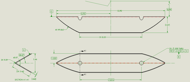

Hi all, I've started working towards learning my way through the ASME GD&T standards but still having a hard time wrapping my head around setting up my datums. I've got this part that welds to a U shaped tube that goes through both 1/2" holes in the middle, and the large radial cut from the top view sits inside a cylinder, not welded.
Is there another way to set this part up? Have I done it 'right'?
