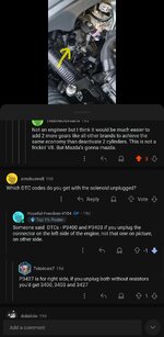

I talked with tuner guy and he said he can delete mistake code and turn off engine light. Why didnt u do this?
I asked a few tuners about it and they said they did not have access to this part of the ECU. This was before I figured out to disconnect the CDA solenoid though. However, I recently asked DR Tuned about it and he asked that I send him the CEL codes and he would see if he could do what you are talking about. Have not heard back. Who are you talking to?
Im from Slovenia, far far away from you. Herr u have codes.

I aslo talked to someone from Germany who said u can turn off engine light, becouse he did it with no problema.
Forscan could probably do it if you knew what parameter to change.
That is the hard part and outside my knowledge.
You could post on the Forscan forum as well.
