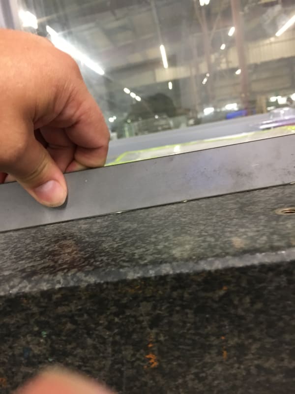

My laser programmer and laser operator are struggling with cutting straight parts. The parts are 11ga CRS 3"x 30" rectangular blanks. When they pull the parts they come off in an hour glass shape. The mid section of the blanks are about .025" smaller than the ends. From my 20 yrs experience I only remember banana shaped parts. We are cutting out of a 48" x 120" sheet, we are using nitrogen for clean cutting. Any help would be great.

I can cut perfectly straight lines on my Amada FO3015 with no problem[cook], can you post a picture of your part?

ive never had a part not cut straight because of cutting conditions, or the way the part is programmed lol its kinda silly, these lasers are very accurate, it would help if you showed a picture "a picture is worth a thousand words"[machinegun]
The part has a 0.020" gap in the middle. it is the same on the other side making is hourglass shaped. I'm trying to get the programmer to change how he processes the sheet. I believe material is moving but just wanted some extra input.[hammer]
