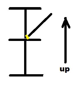

I've got a project in Alaska where our steel turned out warped upon delivery. We've tried to determine the causes. The only think I can figure is that the weld metal has a different CTE than the structural steel does.
I can't find the Coefficient of Thermal Expansion (CTE) for welding metal. Is it any different than A572 or A992 steel?

The item in question was a WT (web pointed upward)to the bottom side of a WF beam. Continuous fillet weld on both sides of the WT web. When it was put together in the shop it was all fine and dandy. It was placed on a truck with the dunnage and strapping placed in such a manner that if any shipping issues caused the distortion, it would have bowed downward.
Instead, we released the straps and it bowed upward. I don't remember the dimensions. But I calculated the required bolt force it would take for the ends to come back down to level. It took (10) 1" dia A325 bolts (it was a rather hefty composite beam section). We went with shims instead. But I kept thinking it had to be something to do with the weld that I did not understand. And the cold weather in Alaska at time of delivery was about -30 F. So, over 100 deg difference from fabrication to offloading from the truck.
If the CTE is the same (and I don't know what CE is) then it is most likely something to do with the heating of the metal and partial contraction, with some yielding. And that is making me nervous. If there was yielding (especially around the HAZ) then we might have compromised steel.

Your last para., “It is possible that there were welding stresses imparted that were just under yield. And that loads applied during shipping pushed things beyond yield.” may be true in a few cases, but generally it is completely bass-acwards. There is yielded material around all welds, that’s what sets up the residual stresses which cause the distortion problems. I’m not suggesting that they can’t break or harm something in transit or by the way they tie it down. But, more often than not, you will tend to straighten long cambered pieces, or remove distortions from other pieces during transport. That’s called vibratory stress relieving.

My suspicion is that the WF Tee was welded to the WF beam from above, i.e., upside down to orientation of erection, in weld position 2F, not overhead in position 4F. It would be like crowning the beam at the deflection due to self-weight, so maybe not surprised at the camber.

I'll have to check. It wasn't my design. And it was about 6 months ago, so my memory may be cloudy on it.
I looked through the files. Yup. I had it backwards. The WT was on top.

In my earlier example, a WT made from a flange and a web, and then made into a WF by adding a second flg., in each cycle of welding the two fillets, web to flg., the welds want to shrink/shorten as they cool, and the only way that can happen is for the member to take a curved shape (circular curve) with the weld line being a shorter circumferential arc than the free edge of the web, in the first case. Assuming I’ve welded the web to the flg. downhand, the WT will camber up, lifting the center of the WT up off the table because of this curvature change. This whole process leaves residual stresses, is held in equilibrium by these residual stresses. Now, in the second case, the WT added to another flg., again welding downhand, the same thing happens, but the WT is much stiffer than the web alone was, so the curvature due to the new welds cooling and shortening is less. To make the final WF straight, I would put the second flg. on the table with several graduated shims under it, max. shim thk. at center. Then, I’d press the WT down to fit the new flg. partly straightening it out, and the second fillet welding cycle would do the rest of the straightening. My beam is not very stiff over its length, so the pressing forces are not too great, as they are ultimately reacted by the new welds. Otherwise, this is not unlike you having clamped your parts together to weld them. But, your parts must have been much stiffer, thus needing much greater clamping forces.
The OP’ers. beam is all steel and the CTE is essentially a constant (.0000065 “/”/°F) for the base matr’l. and the weld deposits, so the temp. change (Texas to Alaska) would not cause deformation or curvature change. It would just cause a fairly uniform length change of the whole part as a function of the temp. change. We just don’t know enough about his built-up beam to make a judgement about what happened. I suspect it didn’t leave Texas as straight as he is being told it was, and the faber doesn’t know what its shape was either, or is hiding what it was. Still, if the piece was put on a very flexible flatbed trailer, and blocked to the trailer bed, or put on a fairly stiff trailer and not blocked well, and then a bunch of load was put on top of it you could get some ‘vibratory stress relieving’ which could cause some shape movement.
