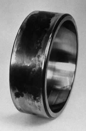

Any hub connection that is not clamped hard enough to resist micromotions due to torque variation and one direction radial loads is destined to experience progressive fretting wear, like the outside of this bearing race -
