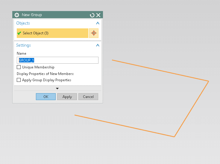

Does anyone know how can I create view in drafting NX that each body will be a block line and pile up?

Ah. It's like how can I create block of some lines like Autocad, so I can choose them faster.
Can you show a picture of what you want made into a block line ?

Looks like you want to put a number of lines in one group.
You can use "Menu - Format - Group - New Group" to create one and add objects to that group.
If you then set the Selection Filter to group, you can select the objects by group.

Yes. That's it. Thanks you so much!
