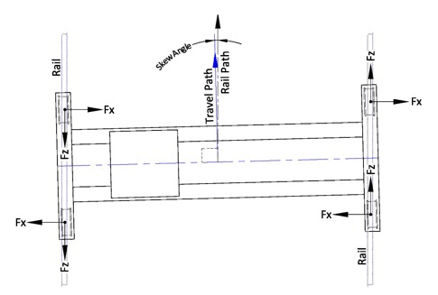

I'm not talking maintenance.....I'm talking forces applied. See the pic I've drawn below.
[URL unfurl="true"]https://res.cloudinary.com/engineering-com/image/upload/v1551465717/tips/railway_btim0m.pdf[/url]
If that "gap" is greater than the lateral deflection of the runway beam (without the backing truss).....there isn't going to be any help from the other side.

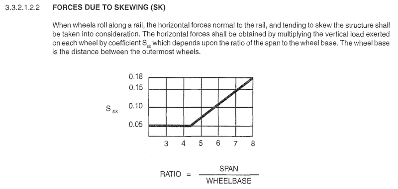

The paper does not discuss lateral wheel loads caused by lateral runway deflections. Rather, it discusses plain old skewing issues that arise from crane issues rather than runway issues.
It's the same thing. CMAA's design manual includes a lateral force calculation from skew that you should include (should it control) in your rail beam design.

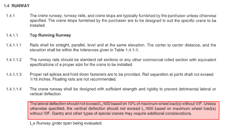

There are two sources of load but only one of them is related to the lateral deflection requirement. And, as far as I can see in CMAA, it's not the skewing version. You'll have to pardon my crappy version of CMAA. I lost access the the latest stuff when I stepped out on my own.
You can tell from the whole span/wheelbase business that the skewing loads are intended to be a localized phenomenon resulting from the applied torque.
You'll not that the lateral deflection requirement is based on a percentage of the vertical load rather than skewing.

AISC Design Guide 7 says this:
13.2 Side Thrust
Horizontal forces exist in crane loadings due to a number of
factors including:
1. Runway misalignment
2. Crane skew
3. Trolley acceleration
4. Trolley braking
5. Crane steering
ASCE has cooked all this into a single number for design (i.e. 20%).

I completely agree that skewing is a source of lateral load. However, it appears that you're assuming that skewing also plays into the lateral deflection requirements. And I disagree with that assumption. If you can back it up, please do.
The language on skewing forces always seems to be like the CMAA blurb posted above: "forces tending to skew the structure". Just like the clip below. What does an L/400 deflection requirement even mean in the context of a torque like that?
I already have have. AISC DG 7 calls it a source for lateral/horizontal forces and gives deflection criteria for the same. You may want to divorce the two.....but you just can't do it. AISC doesn't put out design guides for machines (AFAIK). They do it for steel.
An older AISC Journal article says this:
Lateral forces can be caused by mishandling of loads,
misalignment of the runway, crane skew, and seismic loads.
For design purposes this force is considered to act at the top
of the rail and perpendicular to the rail.
The AISC formula
for determining lateral force is as follows:
Lateral force at each rail = 0.10 × (lifted loads + trolley
weight). Other organizations, notably the AISE Technical
Reports 6 and 13, have similar rules, and these should be
examined as the case may dictate. Also see Table 5.
Lateral deflection should be limited to about L/400.
'Tips for Avoiding Crane Runway Problems', by: DAVID T. RICKER, 4th quarter 1982.
I've drawn that/explained it too. It's very possible that one side could be engaged while the other isn't.
