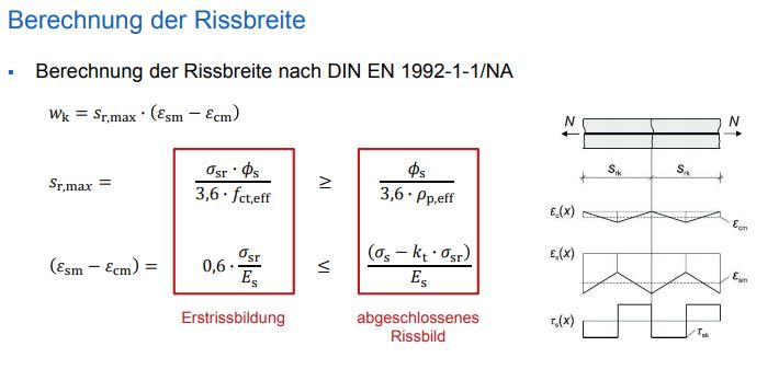

@WARose I actually found it in german commentary to EC2, for "normal case" is the addition not necessary, higher requirement should be used (so long the strain between cracks stays under 0,8 promille.
@HotRod10
on the right side of picture are strains after cracking:
strain in concrete
strain in steel
bond stresses
So there is localized tension in the reinforcement at the crack locations, giving way to compression at locations away from the crack. Ok, I'm convinced of that much, anyway.
Sorry for the lengthy detour folks. The question still remains (at least in my mind) of what happens when the cracked section is subsequently subjected to flexural or axial tension. Does the flexural tension override (replace) the effects of cracking due to shrinkage, directly add to it, or something in between?
