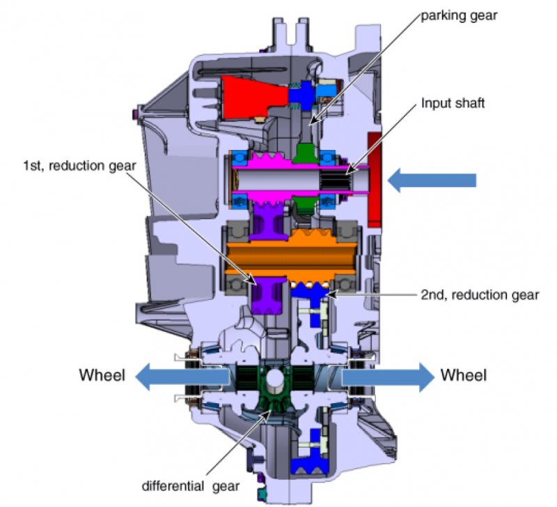

Nissan Leaf: The motor (PM) has a splined shaft output. The reduction pinion (and parking pawl wheel) is supported at both ends by bearings. The detail of the motor's male and pinion's female splines is not clear.
Hyundai Kona, Kia e-Niro: Not much info is available but the (PM) motor has a splined output shaft like the Leaf. The design detail of that spline and design of the reduction gearbox internals are all unknown. These two vehicles reportedly use the same motor and reduction gearbox but the overall gear ratio is slightly different.

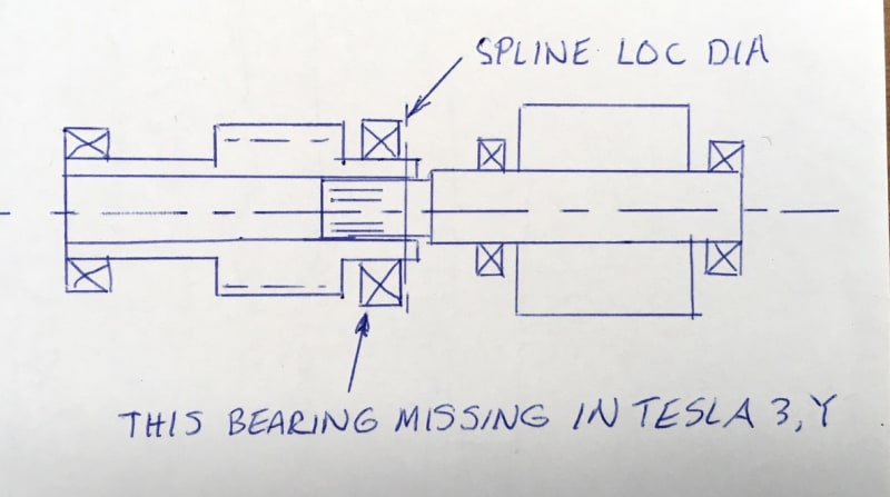

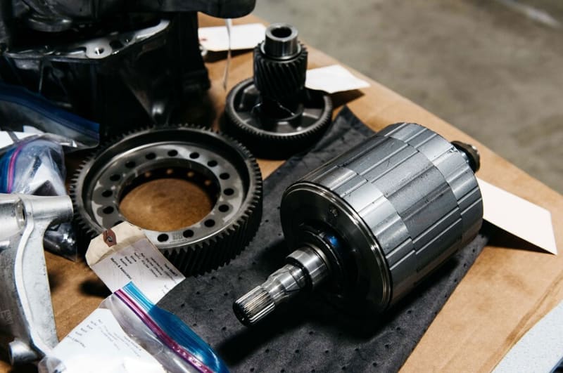

Just to warm this thread up, here are images of the parts in question, the gear reducer and the motor output shaft. Noting that the first stage pinion shaft has bearings at both ends, there must be an over-constrained condition when the splined coupling is under torque. The last reported incident was of catastrophic gearbox failure after a few days of a ticking noise at about motor shaft frequency. The motor spline was apparently in serviceable condition and only the reducer was replaced. I'm guessing that the gearbox bearing closest to the motor was overloaded and perhaps the cage broke apart.

Yes, the photo of the motor in my post just above shows the two hollow dowels. The flange around the motor shaft appears to have an O-ring and may or (more likely) may not provide any further concentric locating between the motor and reducer shafts.

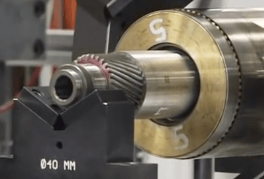

The Tesla Model 3 and Model Y teardown videos by Sandy Monroe indicate that the motor/pinion arrangement is similar with the exception that the gearbox bearing nearest the motor is not present.
Adjacent to the spline coupling in all cases are locating diameters to sensibly center the splined connection when torque is relaxed. In the Teslas, this locating diameter alone appears to support that side of the pinion, effectively utilising the motor's nose bearing. Another interesting feature of the Tesla design is that about the first 1/3 of the motor housing is provided by the reducer housing. So the machining of the motor nose bearing is on the reducer casting. No doubt that's one advantage of manufacturing both units in-house.
My argument is that the Korean design is over-constrained and therefore unnecessarily sensitive to the tolerance stackup between the two shafts. Numerous owners of these EVs are having either or both the reducer and/or motor replaced under warranty due to a ticking noise and one case recently of catastrophic gearbox failure. In a few cases the problem has returned.
With reference to the drawing and "This bearing missing in Tesla 3, Y"). It would be unusual to use the spline itself to locate the pinion shaft. You would normally see a spigot bearing, spherical bush or similar to locate the pinion shaft to the motor shaft.
je suis charlie
Yes, certainly, that's what I mean by "spline locating dia" on my sketch and the text "in the Teslas, this locating diameter alone appears to support that side of the pinion". Here's a photo of the Tesla motor without the pinion fitted, noting the oil grooves.
