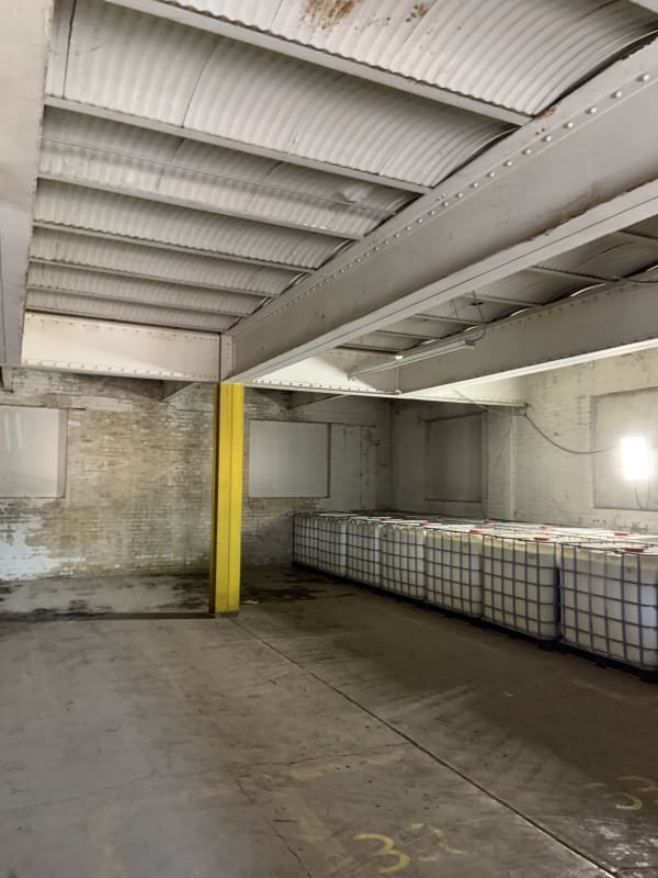

Anyone familiar with this type of floor? Or aware of any reference materials?
I’ve done a lot of searching and have seen a few pictures but that’s about it.
The building is early 1900s I’d say. The arched corrugated panels span about 4-6’ to what I surmise is a jr beam beam cast into the concrete. The jr beams span about 8-10’ and bear on large plated beams and girders.
