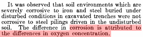

See National Bureau of Standards (NBS) Monograph 58 "Corrosion of Steel Pilings in Soils".
The above quote comes from the Summary on pages numbered 21 & 22.
[idea]
I think the availability of oxygen is also a factor. Black steel gas lines are direct buried all the time, but they're buried deep enough there's not enough oxygen for rust to form.

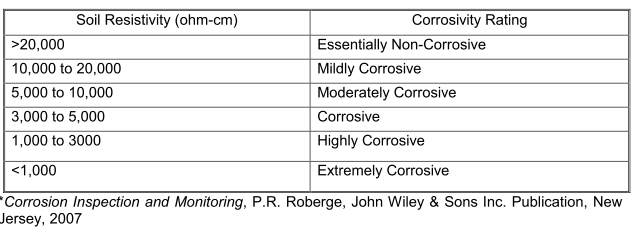

Water municipalities have us test the soil for moisture content, chlorides, resistivity, pH, and redox potential. I couldn't tell you how each one affects the corrosivity of the soil. I know the lower the resistivty, the higher the corrosivity (see below). Typically there are special consultants (not us) that take those values and recommend a corrosion protection system for the water systems, if warrented.
Other than that, I may have seen the oxygen concentration affect steel H-piles on a highway project. We wanted to re-use the piles which where driven in the 1960's. We exposed the upper portion of the piles and they were more corroded in the fill layer (higher oxygen concentration) versus the natural glacial out wash layer (supposedly less oxygen concentration vs. fill)... or the fill just had a lower resistivty. Either way, there isn't a great way to test for oxygen concentration.... is there?

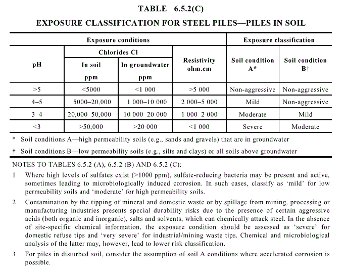

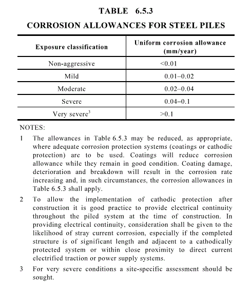

The images below are from Australian Standard AS 2159 "Piling - Design and Installation". Beyond these parameters, I'd suggest specialist advice rather than trying to self-educate unless the risk is low.
