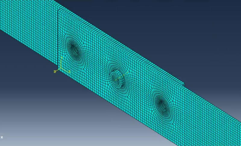

Hello all,
My model is a simple lap joint. Only one bolt is used in this model at this moment. One end of the joint is fixed, and the other end has a displacement B.C. of 0.01 inch.

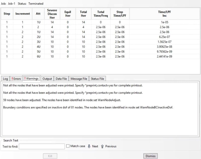

For step 1, I have the maximum number of increments of 1000, initial increment size of 1E-5, and minimum of increment size of 1E-20.
For interaction, I have a general contact where I selected 5 contact pairs, instead of using "all with self". I also tried "surface to surface contact with small sliding". It doesn't converge either.
some screenshots are attached. Appreciate any advise. Thanks.
Try enabling automatic stabilization in step settings. If it doesn’t help, you can switch to dynamic implicit quasi-static step type but it might be also necessary to fix contact issues first - ensure initial establishment of contact.
You also might want to look at making the mesh of one of the parts in the contacting area finer than the other. If they are the same material I don't think it'll matter which you pick but if they are different materials then put a finer mesh on the less stiff material.
Thanks FEA way. I switch to dynamic implicit and it works. Appreciate your reply.
