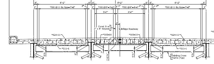

As far as I can tell, our DOT doesn't require rebar shops. We provide a Bill of Reinforcement for each component (generally each piece that will be placed at one time) that includes coating requirements (epoxy coated or plain), bar lengths, the number required, bending diagrams, set diagrams for cut sets, total weights for the bars in each component, and a note that designates a prefix number for the groups of bars (Ensure fabricator prefixes Abutment no. 1 bars with numeral 1, etc.).
Laps not dictated by the bars lengths (i.e. where there's only 2 bars overlapped within a component) are called out in the details; first and last bars in sets are called out, etc. Everything needed for fabrication and placement of bars is in the plans.

Here's a sample of our bridge details and bill of reinforcement. Our spec book and notes cover the rest. For bends and hooks, we reference the ACI Manual of Practice for Detailing Reinforced Concrete Structures.
