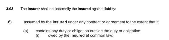

Thanks for all the comments. To round this out i had a discussion with the companies lawyer and they said that using the proposed clause would void our insurance.
And to add to this, the extent of the cover is not related to the fee. (it is in real life though, I am sure you would draw the line when legal fees start exceeding the design fees!)
update, as i go t in trouble from the lawyer for using the word "void" Her exact words were: "I have since spoken with our insurance advisor. He confirmed that we would not be covered by our professional indemnity insurance for any liability that arose as a result of adopting the requested amendment to clause 3 since it goes beyond the common law obligation that is covered by insurance – per the existing clause 3 of the ACENZ (industry approved) contract. Therefore clause 3 must remain in its current form, for insurance reasons."
and the insurance clauses:
