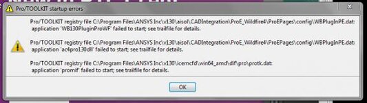

ANSYS 13 linking with ProE WildFire 4.0
I did the same using the ANSYS CAD Configuration Manager. The configuration was successfully done but after that when i started ProE WildFire 4.0 i got the following error message. I have attached the screenshot of the error.
Please Help how to solve this problem.View attachment 6691
