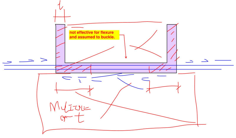

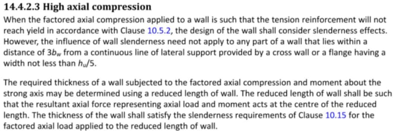

Recent versions of Canada's concrete code now direct users to consider parts of the core shape to be ineffective. This is very similar to what is done with cold formed cross sections and is equally annoying to implement. But it's difficult to argue against the logic of it. It also kind of begs the question of just how comfortable we should be relying on buckled portions of the web to transmit shear. I've been turning a blind eye to that because, frankly, this stuff already causes me enough problems. I don't need to manifest myself any additional ones.
Would you be able to post a snip of that code section?

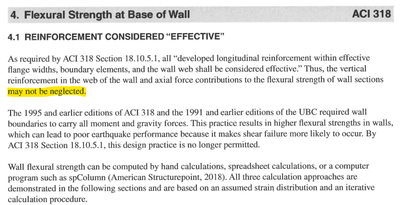

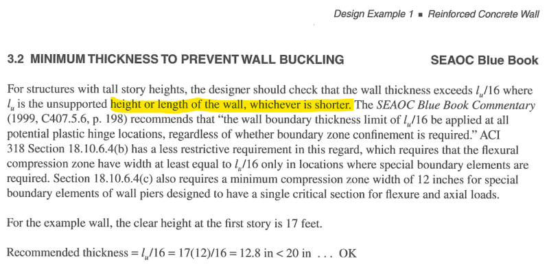

There is some commentary in the wall design example in the SEAOC SDM Vol. 3 that I think is relevant as well.
Regarding buckling:
Regarding neglecting portions of the web:
I imagine that the highlighted blurb in the second clip is really speaking to not underestimating the rebar in tension in the web of the wall shape for fear that would underestimate flexural overstrength in the wall for seismic. I don't think that it is forbidding parts of the wall from being ignored wrt compression.
I do very much like sticking with an h/XX approach. You know, because it's tractable / easy.
That makes sense. You want a wall that will yield ductility in a flexural mode, which means you need to ensure the design shear capacity is greater than the 'real' flexural capacity.
