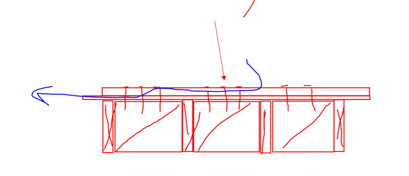

Curious about everyone’s thoughts on lateral stability where props line up on / near joists. Does anyone have a good feel for what kind of blocking might be reasonable to mitigate twisting / weak axis eccentricities / buckling at the point loads (see my sketch below). Short of blocking the entire cavity from one side to the other though I don't know of a warmy + fuzzy way to resolve that. Presently I'm thinking connecting all the MP 350 props in E/W direction (perpendicular to joists) and relying on the fact that the props/frames offer resistance against lateral displacement (through connection to my 3/4 ply plates / direct into joists with lags. There's obviously fastener slip concerns there but that probably wouldn't be large).

1) I might consider providing your shoring system with it's own, internal lateral system such that you are less reliant on the existing diaphragms. Obviously, at three stories in height the shoring probably cannot be treated as truly free standing.
2) However you handle your gravity load through the floor plenums, I think that your diaphragm connection ought to be done as I've shown below: provide a drag strut into at least two blocked floor joist spacings. I don't see a significant benefit to having sheathing on the bottom of this.

KootK : To your point 1 that would be the idea of connecting everything with MRK frames at least in the one direction (was thinking top/bot to make towers all the way down). Which bleeds into point 2 in that I agree with dragging the brace load into the existing diaphragm. The idea behind the plywood underneath was that if I truly don't trust the existing than at least the joists + blocked area can be relied on to maintain it's shape (so not have top displace relative to base over that fully boxed area) and the notional brace load could then be taken by the MRK frames from floor to floor until it meets grade where I have my frames pinned to the SOG. I mean, that makes it effectively a single tower from SOG to underneath slab but that's if the existing has absolutely 0 brace capacity...which I cant imagine. I have to dig into Peri's load allowances for towers over certain heights / required MRK configurations. They have a nifty tool for doing that.

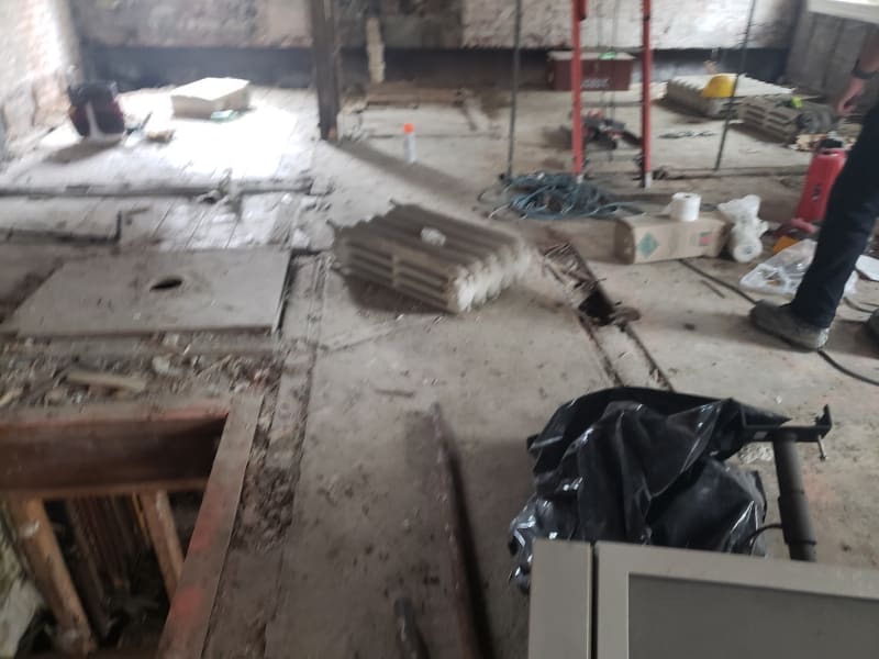

Since this was the very first one of these I've done and I was more than a tad nervous about it I thought I'd share the update that it worked. Slab is poured and held without fuss. Ended up assuming that the peri prop structures were towers and provided the bracing to do so per their online gizmo. If you haven't seen it it's rather neat. It will tell you the required configuration of MRK frames for a given load / height.
Also, basically did what was discussed in the thread for the various prop conditions at the subfloor but also added full length blocking across the entire floor at all prop locations. It was a small area and contractor was happy to do it for added assurance as it was actually his suggestion. In this case it was a contractor I went to school with so he's rather good like that. We're on the same page about the vast majority of things but that gets interesting sometimes because it also emboldens him to go his own way on things he thinks I'm "overkilling" sometimes [lol]. But to his credit he's usually correct and I've also always considered him the better engineer of the two of us.

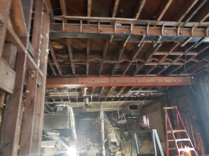

I wasn't called for an install inspection sadly so I don't have pictures of the shoring in-situ / blocking details (see note above about overkilling...also, there might have also been a lack of frame availability for the top props) but here are some photos from the floor to give you an idea for any of your own future work. Floor was shitty as all hell but I felt pretty good about providing bracing for tower configuration as I felt I could make the pin connections kind of realistic / like it would be in a proper tower.
SOG
Framing
Typical SubFloor
