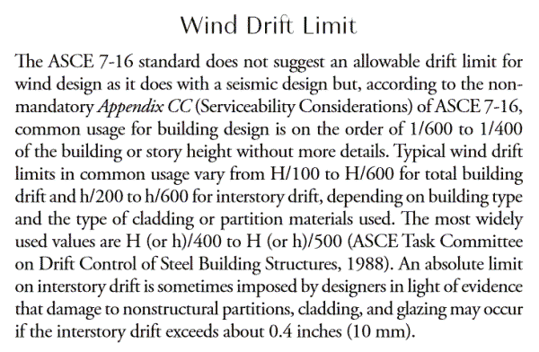

Dear All, I was going through a design of industrial shed with concrete columns till roof(around 7m eaves height). The roof sheeting is supported by rafters which rests on the concrete columns connected by a base plate. My question is, do I need to check lateral deflection of concrete columns due to wind loads with a code prescribed limit of range H/400 to H/600? Do I need to consider just the wind load reaction from roof rafters or also due to wind loads acting on all four sides of shed, distributed to columns? Does someone has experience designing such kind of structure?
You would consider the wind load acting on the entire shed, and the effect on each element according to how it distributes through the structure to the ground.
However, for an industrial shed, there may not be as many concerns about lateral deflection due to wind. Occupant comfort may not be a factor, and the cladding materials (you mention sheeting for the roof) are often more flexible. H/400 and H/600 are limits more common for structures incorporating masonry, glass, etc.

Still wondering if someone can guide me to some reference for deciding deflection limits for such cantilever columns.[hourglass]
MSUK90 said:
...guide me to some reference for deciding deflection limits for such cantilever columns.
"Structure Magazine" December 2019
SlideRuleEra, I am aware of this clause. Am I doing the check correctly considering H/500 as displacement limit in your view then?
The only issue I face is very deep columns for such limits and no client likes it.

MSUK90 - So, you consider 70mm lateral deflection to be to much for concrete block walls. That rules out H/100.
From your previous post you consider H/500 acceptable.
Code reference is required for approval.
Then you have narrowed down possible answers to two choices by the process of elimination:
Based on reference cited in the Structure Magazine article, H/400 or H/500
Use H/500, since that is the value you considered acceptable.
