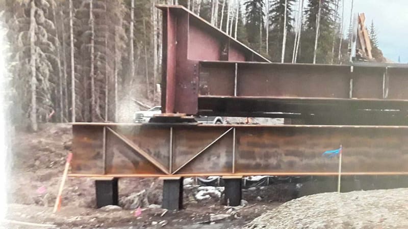

The inverted diagonal stiffeners connecting your bearing stiffeners on the cap beam are not doing anything. You can remove those.

We got biased by a design where diagonal stiffeners were used (photo below). We will take a look again. You're correct about load sharing of piles. The middle one in the set of three takes nearly 50%.
Location and site class indicate that no seismic analysis is required. But the idea of a bumper is good, as there is longitudinal braking force to consider.
Not trying to nitpick but you asked for comments. The diagonal stiffener arrangement as shown is doing nothing. If there was to be any load sharing across the piles, the stiffeners should have been inverted the other direction.... but even then it is minimal. I guessed on the aspect ratios, but see attached.
You would be better off going with two piles and splitting the difference either side of the bearing (however, that doesn't help you with your longitudinal seismic resistance). Now in reality, the middle pile would get overloaded, displace downward and then engage the other two piles, but that is not how we design.
