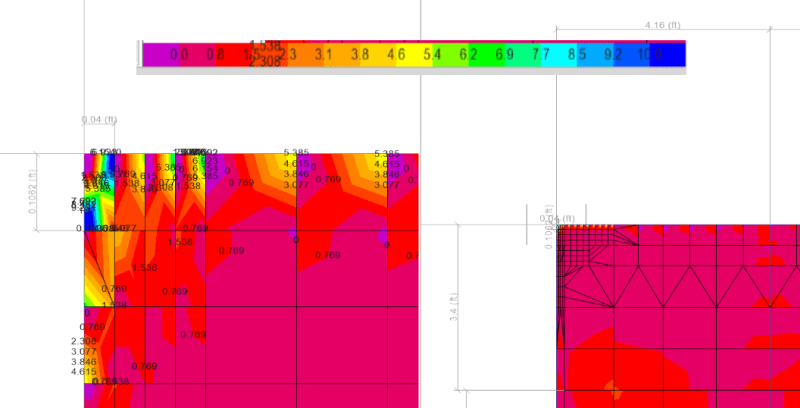

wrxsti said:
based on the fem model which i redid for the slab to cover entire bay
where in the load is distributed
The majority of slab is not overstressed
only the corners the stress values go up really high
this is NOT normal though right ?
Please excuse my ignorance, as I am not accustomed to interpreting this type of drawing. The surface has two colors, red and purple. The corners appear red, but so does a substantial part of the remainder of the floor. Does this mean the red area is highly stressed? If corner stresses are really high, shouldn't there be a different color to signify a trouble spot?
It is normal for corners of a rectangular area to be highly stressed. They are sometimes called "cornerlevers" because the corners are trying to lift up but are held down by their attachment to the supports. The code I used years ago required special reinforcement in the corners without precise analysis. The intent was simply to alleviate cracking in those areas.

The color at the corners are darker, but as OP pointed out, it is about 1 sf, too small to be distinguishable on the PC monitor. We are on the same page as the corner bars goes :)
retired13,
I do see a black smear in each corner, but I thought that was just text printed very close together. I would have said the red color in the two corners is about the same shade as a fairly extensive section in the central area, but I can't claim to be an eagle eye, so I accept your assurances that the corners are darker.
BA

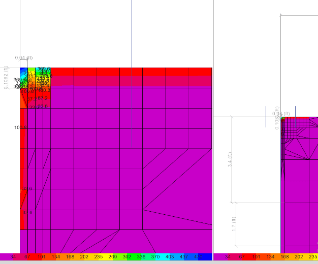

hey sorry got busy ok i increased the mesh maybe i need to do some more
here is the Mmax
and here is the Vmax
shear values going extremely high up to 398 kips
i will try with some end releases at the corner and post results
Check the model with self weight only, then add the concentrate load to see the changes. It might point out where the problem is - the model, or the load. If everything ends in no avail, try one run with a stiffer beam to see the improvement.
