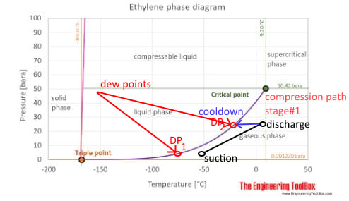

Why these two design have difference?
What is the reason for that?
Do not think twice
so overall temp will reduce but not less than suction temp (it will in b/w both of them ) so no chance of liquid droplets
You seem to be comparing at equal pressure level. The reality is that pressure at discharge is higher than suction which means dew point may increase and it may increase significantly or not depending on your liquid-vapor phase envelope. It may work but we do not have all the details.
But certainly, relying on suction temperature as criterion means you are ignoring the above.

For dew point analysis @ main feed it is : pressures @ 1st stage suction and 2nd stage suction.
See attached a generic example to illustrate the concept (applies generally).
Obviously considerations are to be taken into account, for example if side stream and main feed stream have identical gas composition.

Let's say 2S stage suction at dew point (7 bar -62C) than 1 S dicharge will definitely superheated after compression (7.2bar 20or 25C) and mixture will be will give temperature more than -61C so superheated
except suction at dew point and 2S high flow than 1S discharge
Reference to your quote for the part in bold:
If you have pure Ethylene (main feed and side stream being identical gases) and side stream is super heated, not even then.
If side stream not superheated than also some things mixing with this is superheated (same ethylene )than mixture will be superheated
'' Let's say 2S stage suction at dew point (7 bar -62C) than 1 S dicharge will definitely superheated after compression (7.2bar 20or 25C) and mixture will be will give temperature more than -61C so superheated''
