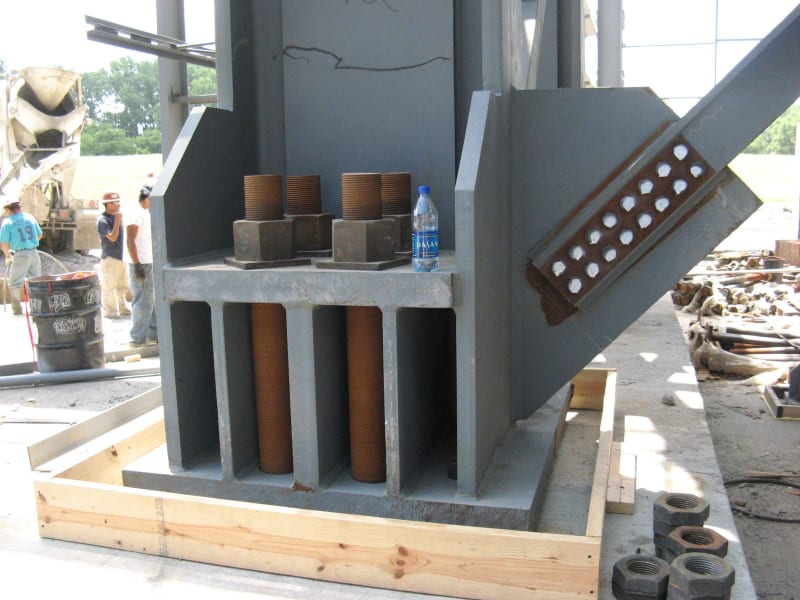

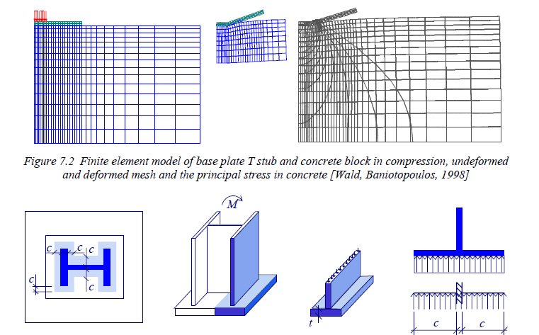

The EC- 3 approach is similar to your thought. The following picture depicts the T-stub concept and stress distribution under the base plate.. Another criteria is,the bearing resistance of concrete is about 6 times higher than compression resistance of the concrete and for a square base plate is 5fcd is used.
P.S. Will you please guess the size of anchor bolt and base plate thck?
That picture describes things perfectly HTURKAK! Star for you.

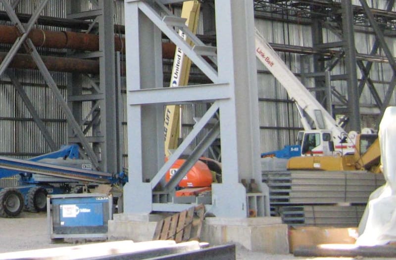

Put me down for 1.5" anchors and 3" on the base plate. Supporting an overhead crane?
“Any idiot can build a bridge that stands, but it takes an engineer to build a bridge that barely stands.”
maybe a pipe rack or overhead conveyor...
Yes ..supporting O/H crane.. but regarding your guess, see the picture below to compare the sizes..

EC-3 approach based on T-STUB concept ,( tested with a lot of experiments ) and assumes effective area having perimeter around the column with a distance 'c' which depends on the strength of grout and thickness of base plate. That is, one can not obtain fully uniform bearing stress under the base plate by increasing the thickness within practical sizes.

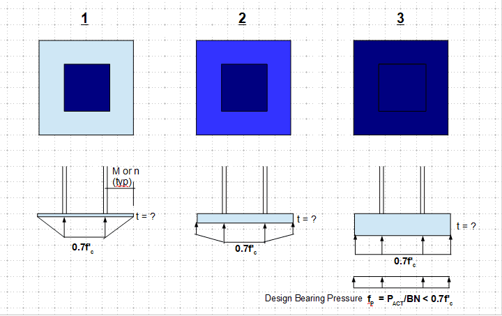

Regarding your sketches, are you proposing to adjust the thickness to get an intermediate bearing stress distribution?
HTURKAK,
My diagrams above encompass all forms of stress distribution under base plate for the concentrically loaded column, and there is always a bending in the plate outside of the perimeter of the column due to cantilever action, assuming the column is much rigid than the plate and the concrete. While all plates may pass bending check, but the magnitude of deflection varies. The thin plate in case 1 could deflect an amount that is unacceptable, and deemed it has "failed"; the third case is overly conservative (true uniform stress distribution and near zero deflection), unless necessary. Therefore, AISC adopted the second case with the concentrate load conservatively distributed to the plate uniformly, which will encompass all stress distribution variations between cases 2 and 3, yet yield satisfactory result (moderately flexible). So the claim on AISC has ignored plate flexibility in the formation of this simplified method, IMO, is false. Hope this helps in clearing up the confusions.
