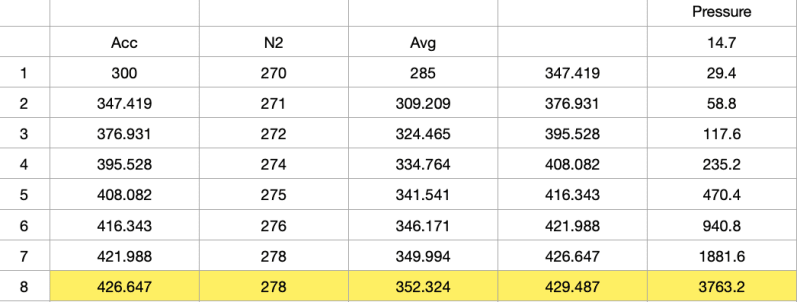

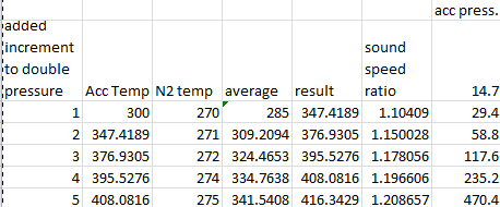

I calculated at each step where the gas pressure in the tank doubles - which means that half the gas is from the external source. Then at each step I take the average temp and calculate from that the temperature after compressing it to fit the accumulator volume and iterate to around 500 psi. Note that the constant enthalpy curve rises as the outlet pressure rises; it's not much and makes little difference, but I estimated the effect.
Then I looked at the ratio of the speed of sound at that temp to the speed at roughly standard conditions. That gets a result that the outlet should be M1.2 from a temp of 420K ; they were getting M1.35 which should require a temp of 520K. Perhaps that comes from heat picked up between the bottles and the accumulator (a small amount?).
Here's the picture -
Maybe part is that N2 is less dense than average air (28 g/mole vs 29 g/mole -> another 3% bump)? Maybe the gas heats a little more or the bottles were hotter than 80F from being in the sunshine? Possibly friction losses in the lines from the bottles to the accumulator? It seems like 410K-520K is a big jump, but perhaps it's from a bunch of little additions.
Correcting for the changing temp from the nitrogen bottles makes a tiny difference; it's not -80C.

This isn't actually what I was getting at at all. But, since you brought it up, good point. Your algorithm for finding a solution provides no mechanism for the temperature increase to ever stop. And I suspect you know this already, because dragging your equations down two more rows is pretty easy. Look:
This means I've got gas at the same pressure, and thus the same volume, but at a much higher temperature. This very large enthalpy change, according to your algorithm, happened without any external work being applied.
What I was actually getting at is that you're neglecting the source of the work being performed on the gas, which is the internal energy of the gas itself.
Internal energy in an ideal gas has no relationship with pressure at all; in a real gas the relationship is very very weak, to the point where it can be disregarded. What you're describing in your algorithm is a situation where the total internal energy of the gas in the system (including the gas in the bottles) is increasing over time, without any additional external applied work. A system that works as you've described is a perpetual motion machine.
