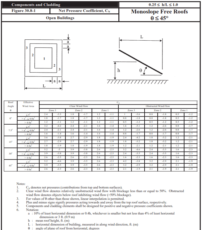

I use monoslope free roof with roof angle 0 from ASCE 7-10 for both upward and downward loads. If it ain't broke, use it.

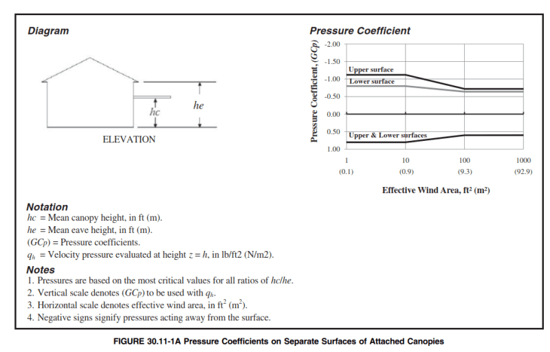

Speaking of Canopies, what is guiding principal of weather to use the Figure for "Pressure Coefficients on Separate Surfaces of Attached Canopies" vs "Net Pressure Coefficients on Attached Canopies Considering Simultaneous Contributions from Upper and Lower Surface"
Furthermore, in ASCE 07-16, Figure 30.11-1A, why do they list hc & he?
Are upper surface and lower surface added together for upward and downward?
In the end, I suppose it would be safe to take the critical load from CC (monoslope enclosed, monoslope open, canopy or MWFRS). Not ideal, but comprehensive.
" Pressure coefficients on separate surfaces of attached canopies on buildings" are used to design fasteners of the top and soffit elements that's why you have coefficients for both faces. Ref ASCE 7-22 Comm. C30.9
"Net pressure coefficients considering simultaneous contributions from upper and lower surfaces on attached canopies on buildings" are used to design the structure of the canopy (girder, joist, post)Ref ASCE 7-22 Comm. C30.9.
It is also for canopies with only one physical surface.
I think this is to account for differences in the canopy and roof elevation when you refer to the "Net pressure coefficients considering simultaneous contributions from upper and lower surfaces on attached canopies on buildings". The height of the canopy relative to the roof affects your wind pressures (both +ve and -ve) as qh is used to compute the pressure
If you're using figure 30.11-1A from ASCE 7-16, no. it is already combined in figure 30.11-1B Net pressure coefficients considering simultaneous contributions from upper and lower surfaces on attached canopies on buildings.
