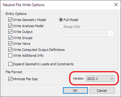

a vendor of ours is using version 22.2 and their .NEU can't be read by our version 11.32.
What to do ? Can they save in an earlier version ??
Yes, in neutral file export menu vendor can chose older version for .neu file.
thx, I think this was a PEBKAC issue ... I gave up at the warning, then someone said that it works, so then I went to view/display/all and there is was !
thx again.
