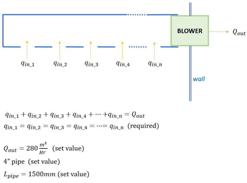

Hi all,
A little disclosure before my question, the last time I had anything to do with fluid mechanics was 7 years ago so if my question is somewhat trivial don't be too harsh on me.
Now to my questing:
Given that I have (something of) a combining manifold (single outlet and multiple inlets), the structure of the manifold is a straight pipe with a blower at one end (the opposite end is closed) and several inlet openings along the pipe's wall (the inlet holes are on the pipe itself, no extensions).
In case I want equal flow rates from all the inlets, which means that I have to "adjust" the cross section of the inlets (intuitively the closer the inlet to the blower the smaller the opening should be to restrict the flow).
How should I approach this problem, given that the Q_out and pipe dimensions are known.
After searching a bit I found some sources that use the Bernoulli's equation and other sources use the 'generalized macroscopic energy balance', in any case I'm lost.
Thanks,
SD

Thanks all for the replies.
Yeah, I should have attached at least a basic schematic of what I'm talking about.
In general this is sort of a "though experiment" that got me intrigued enough to dig deeper.
The pressure source is at the outlet and the inlets are just openings in the pipe itself, open to the ambient air of a room.
I really don't need an exact equality between the inlets flow rate, guess a 10-15% deviation will do just fine.

That's why the designer would use the same velocity criteria to size the inlets at 4-Inch diameter.
In the more common situation where the manifold is on the delivery side of the pump or blower the rule of thumb is to keep the pressure drop along the length of the manifold to less than 10% of the pressure drop through the holes. This should keep the maldistribution to less than 5% with all the holes the same size. I believe this same rule should be applicable to the current example with the manifold on the suction side.
Keeping the pressure drop along the manifold low can be achieved be either oversizing the entire manifold or by stepping it as shown in Latexman's photo. Like everything else in engineering, the decision is guided by economics.
