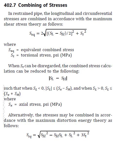

I notice in B31.4 under 402.7 Combining of Stresses it says you may combine stresses using maximum distortion energy theory. Which I believe to be Von Mises approach. So I used hoop + thru wall bending as stress in X direction, and thermal compressive stress as stress in Y direction, calculated principal stresses, and then Von Mises stress from principal stresses. Seems reasonable to me.
My crossing point is in an oil sands tailings facility, it will be crossed by D8s and maybe the odd 3/4 ton pickup truck, nothing more than that, so I think this will be good.
There is an ASME clarification dated 1992 prohibiting use of Von Mises Distortion energy (the basis of my previous comments) here. I do not have a copy of the latest edition of B31.4, so it would be helpful if you could post a copy of paragraph 402.7 I and maybe others would like to see it, as it may be a significant change to previous editions, which also may affect their previously issued clarification that apparently has not been withdrawn. Maybe we should ask for a clarification to the clarification.
The clarification to which I refer as well as other historic clarifications published by the ASME code committees can be found here,
Von Mises Distortion Energy.
Einstein gave the same test to students every year. When asked why he would do something like that, "Because the answers had changed."
From 2019 version which is the latest current version.
Thanks LI.
This is interesting too.
So, "alternatively" you can use either answer.
I feel a clarification coming.
