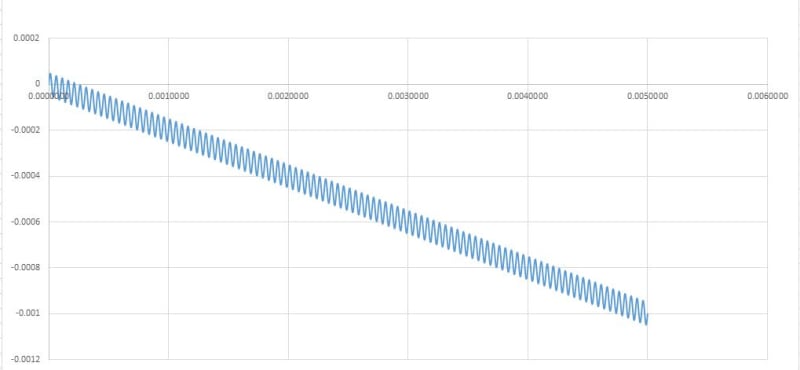

I have an analytical part, and i want that part vibrate in sinus manners meanwhile move down toward the second deformable part.
Now, how should i did something like that?
with best regards.

Not sure I understand exactly, but perhaps this might give some ideas. Use implicit dynamics, with an enforced displacement on the moving part and a sinusoidal time varying force/pressure. These two should ideally be applied at different locations, so they do not cancel each other out. Finally a contact can be used between the moving part and the second part in case they will start touching at some point

My amplitude should something like This:
Now how can i make my Analytical Part move like This?
with best regards.
yassou.
Define an amplitude curve in abaqus cae describing the graph you showed, then define a boundary condition for displacement and assign this amplitude data to it. The following link covers boundary conditions that vary with time: Link
Amplitude curves are defined:Link
Just create two tables (sinus and linear movement) in Excel, create the sum of the two and bring that as amplitude to Abaqus.
