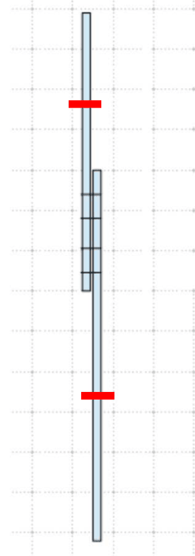

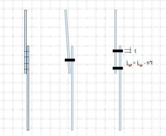

Ask the contractor to submit the spec of the spacer to be used, and sketch the detail of the application to ensure the case in the middle of the sketch below will not occur. The detail on the right is another argument against the contractor's claim on strength gain through add'l bonding, unless the thickness of the spacer is negligibly small.

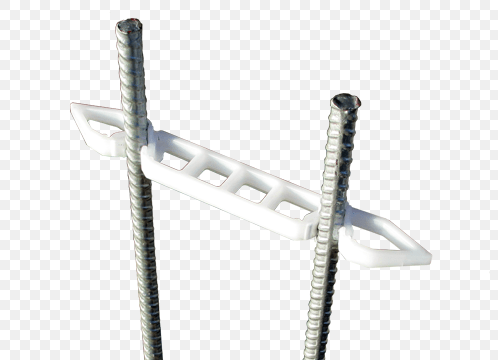

I think they are trying to say that the bar positioner creates a gap between spliced bars, but the spec calls for a contact splice with bars wire-tied together. You can have one or the other, but the gap caused by the positioner precludes a contact splice. They are probably envisioning this type of positioner:
bones206's comment makes sense.
bones... nice... first I've seen that. My life is becoming too sheltered. I'll use that in future.

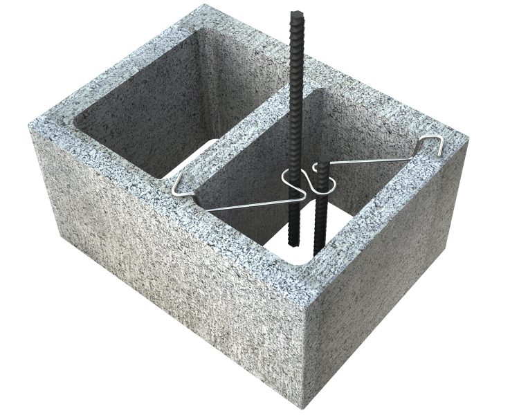

or maybe...
Looks to me like they could, and should, do both. Anyway, without tying them together, what keeps the upper bar from falling down to the bottom of the wall?
Other than bones206 provided, I guess this is what the contractor had in mind. If this is the case, I vote against it, as it could be problematic for the quality of grout around the splice.
