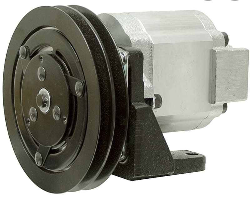

Had a question popup this morning -
"Good morning, y'all - xxx just stopped by to follow-up on his email about the clutch. He's more than satisfied with the service factor on the clutch model. In regards to his other question, he volunteered that the online website for the component that he looked up had an 11 gpm capacity/rating.... I admit ignorance in knowing exactly what he was referring to, but maybe that makes more sense to y'all in context of his question... What is that 11 gpm capacity/rating?"
My initial response was that clutches are measured in torque and service factor, but googling around shows various "clutch pumps" measured in gpm.
Ok, so I usually deal with rotating machinery 2500hp and up, so I discovered a hole in my knowledge. The application in question is for a fan on a fired heater application which apparently is going to have a clutch. What is this 11 gpm rating? How can I get more information on how such a system works?

A 'clutch pump' would be a hydraulic pump driven by a belt drive through an electric clutch mounted to the pump shaft. The gpm rating would be that of the pump running at some rated rpm.
Ted
I can see a manufacturer correlating a clutch with a GPM if the clutch was sold with a pump head as a package. Vickers 45V series pump (eg) can be loaded with a range of cartridges with different flow rates. Depending what cartridge is loaded the pump may need a different clutch.
If you go to the clutch manufacturer don't expect them to know this. You're going to need to calculate the torque based on system pressure and GPM.

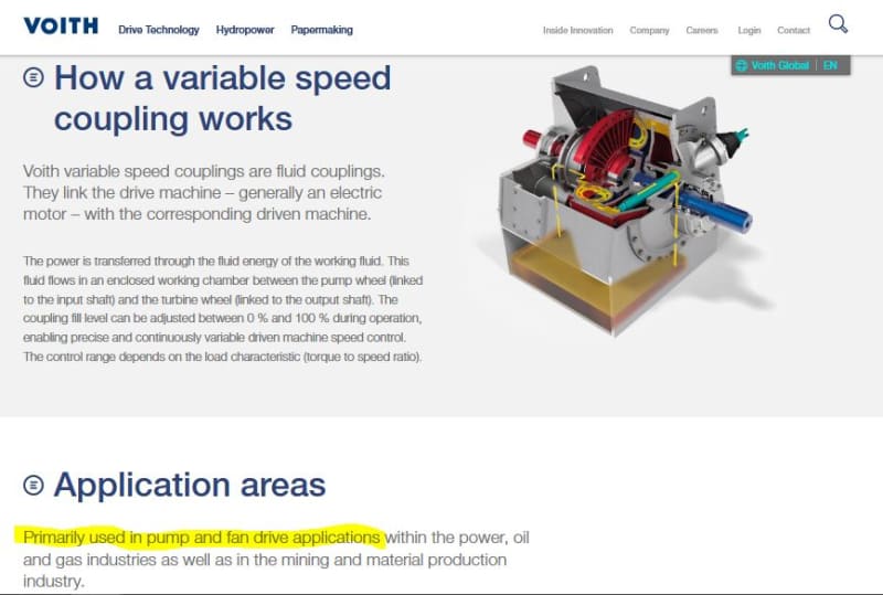

I'm familiar with the Voith products for turbomachinery, but I don't think that's it. The question originally came from our fired heater specialist, so it's likely this is for an induced or forced draft fan. Most of those I've dealt with are either single speed or on VFD.
I've not seen one with a clutch and can't figure out where this clutch pump measured in GPM fits in.
"he volunteered that the online website for the component that he looked up had an 11 gpm capacity/rating..."
No website, no answer....
From Voith website -
If there are speed fluctuations or the fan is re-starting while turning the fluid coupling will help eliminate exploding couplings. Not sure about the cost comparison between a VFD and a variable speed fluid coupling.
