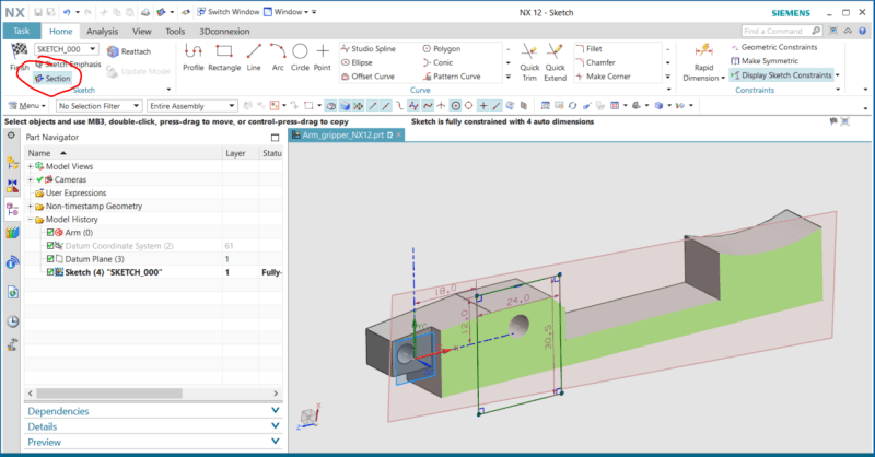

If you are in "Sketch Task Environment" the you can use Section to clip to the sketch plane.

Matnas that's it!! Thanks
however, it appears that might not be available in nx11 ! I don't have that button
Should be there in NX11. Try using the command finder. It will let you add it to your toolbar

While in the sketch, open the view tab and use "clip section" (select the plane of the sketch for the clipping plane).
