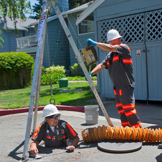

In my jurisdiction, anyone entering a manhole needs to be wearing a safety harness with a means of hauling/winching them out of the confined space.
A Ministry of Labor Inspector would issue a hefty fine (to the business) if they caught a worker in such a place and no rescue tripod in place.
You MIGHT get away with it if you added an approved anchor point/loop on the bottom of your container structure, directly over the manhole, capable of attaching a pulley and rope, in lieu of the rescue tripod.
I would not want to be on the crew that has to lift up a manhole cover with only 4' of clearance.
Sounds like a workplace strain injury waiting to happen.
The aforementioned anchor point/loop COULD be designed to assist n lifting the manhole cover too.
I would not design it the way that you are describing.
OSHA Confined space regulations state that a confined space rescue plan must be part of every confined space entry. Manholes almost always fit all of the definitions of a confined space. Recommend reading this guidance You will almost always wind up with this, just like bacon4life suggests.
