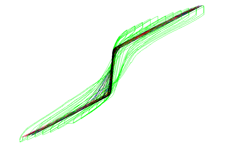

Hello everyone!
I have a question about my simulation.

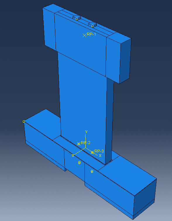

I have already built a model of the rocking wall by Abaqus CAE.But the result of the cyclic loading test is far from the modeling result.
I don't know hot to fix it.
Is the green data the real result, and black is your FEA? if so, hot tip, the step change at the end of the loop is probably 2* some sort of friction-like component.
Cheers
Greg Locock
Dear GregLocock,
Thanks a lot.Now I konw the influence of friction. But if I want to adjust the model or the test result to be consistent with each other.How can I do?
Could you give me some advice?I'll be apreciated to it.
