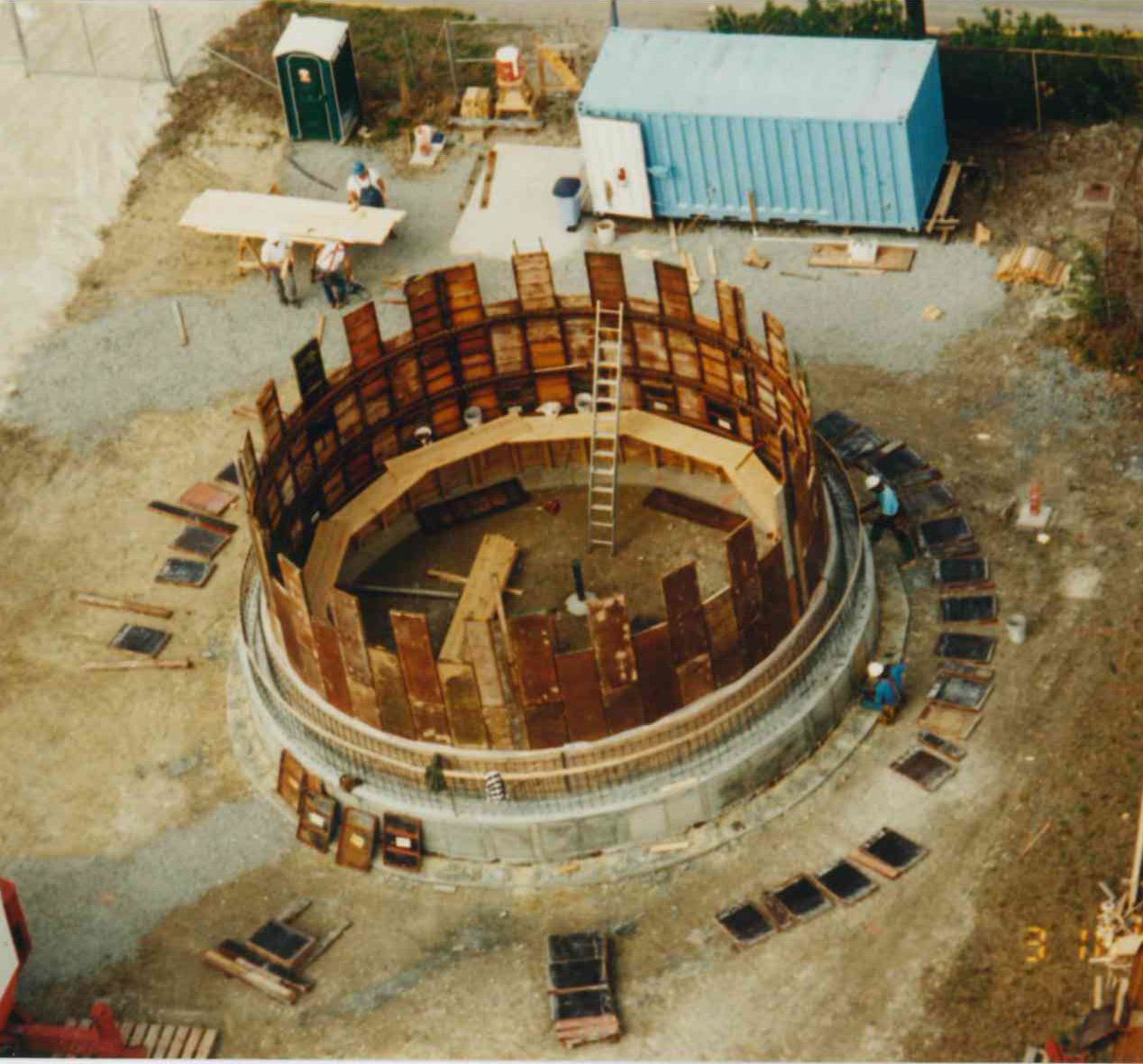

Pay more attention to the lateral loads. The piles (as structural elements) may be adequate for lateral loads, but it is unlikely the soil will be. Typically, 12' embedment is nowhere near enough to support heavy lateral loads on a 64' cantilevered wall... sure, there is some ring steel, but is it enough to resist all lateral loads by itself? IMHO, don't expect ring steel and cantilever support to share the load... design for one or the other to do it all.
Also, IMHO, framed circular cofferdams (excavations) are accidents waiting to happen. If lateral load is not equal around the circumference, the circular structure may be (without warning) catastrophically unstable. Get with the geotech before proceeding... and forget the (false) allure of minimum wall length (circular crossectional geometry) - go with square, or a caisson:
[idea]
I have never design a large circular shaft (if its similar to SRE's) picture. However the first thought I had was that 12ft embedment is definitely not enough! I hope you have a few rows of ring steal beams to add support.

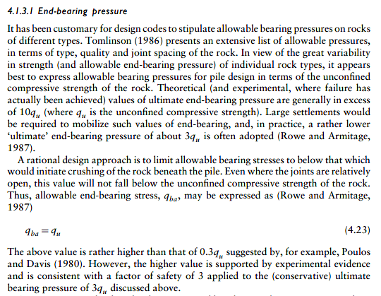

If you are looking at using end bearing in rock you should use a high factor of safety to account for the large displacement (up to 20% of D) required to mobilize end bearing. We typically use factor of safety of 6. I have also seen end bearing being taken as 10% of its ultimate value. I accept its a temporary structure but i still wouldnt take any chances.
EireChch & SRE, for circular cross sections you really don't have a cantilever. It's all just a big compression ring. So it's not like a straight retaining wall where you need to mobilize passive pressure in order to balance the active pressure. As long as friction can prevent the walls from sliding down and if you're not concerned about seepage, I don't think you theoretically need embedment at all. We've seen examples of shafts like the one I'm designing be constructed with no ring steel at all, some of them published in engineering magazines. Our design does have ring steel and embedment, however, accounting for unbalanced loads and pile install tolerances.
EireChch, I ended up finding a section in my Das Foundation book that calculates rock bearing from unconfined strength. Section 11.13, pg 579 in the 7th ed. It basically takes lab unconfined values, divides by FOS of 5, then multiples by tan^2 (45+phi/2). Is this method related at all to your FOS of 6?

I was applying my experience in non-ciruclar retaining walls and going with instinct re the embedment depth, maybe youre right. I dont have enough experience in circular shafts to comment any more.

I checked Das reference and the factor of 5 on UCS is based on the scaling effect. The UCS value is 5 times higher than the actual value, so when you divide the UCSlab / 5 it becomes UCSdesign. I have never heard of that approach and I have only every seen it in Das. Maybe others can comment on its acceptance or usage?
I use Flemmings book for pile design. He recommends 3 x qu (Rowe and Armitage 1987) but also comments that Poulos and Davis (1980) use 0.3qu. Based on our local experience in soft rocks we use 2.5qu / 6 (FoS).
Piling Engineering 3rd Edition by Flemming et al. is a great reference, I would encourage any geotechs working with pile design to get it!
EireChch, wow that's quite a wide spread. It looks like the Das book is similar to your method. The tan^2(45+phi/2) ends up being in 2-2.5 range. Thanks for the help, I'll check out that reference on pile design. It looks like I'm going to be doing a bit more of this stuff in the future. Which is cool! I wasn't expecting to get into this type of work but it's turning out to be a big compilation of all sorts of Civil principles - soils, water, construction practices, structural design, etc.
