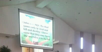

looks like it was a curved internal ceiling.

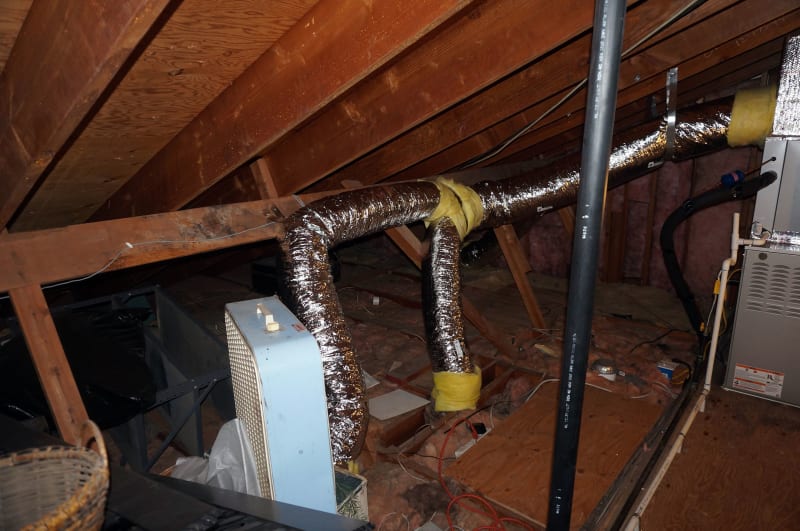

Yes, we have a terracotta roof...
...and in the attic you can see that the roof joists are on narrower spacing than you'd expect and are made from wider boards:

The two light trusses cause me concern.
We have a few of these at my church.
Before we went all digital on the lighting, we were very careful about how many lights we hung.
You have beefie Purlins as well John.

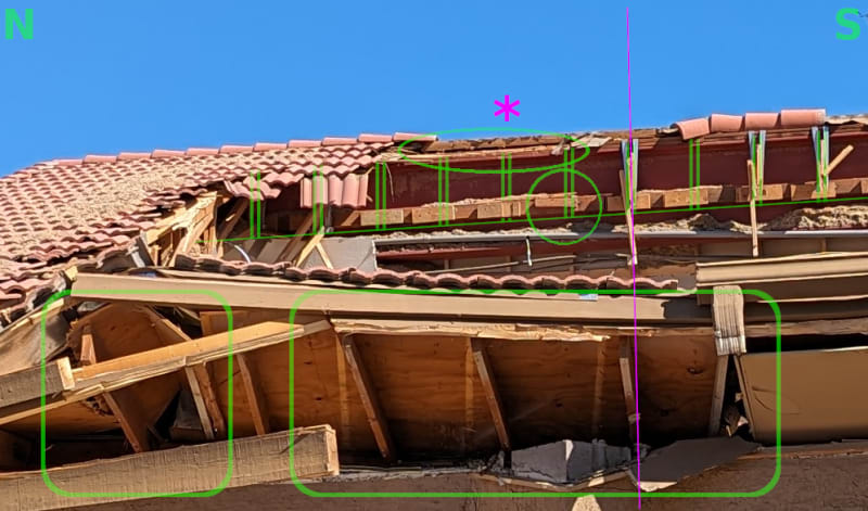

azcats (Structural) (OP) 30 Oct 23 16:06 said:
Let's see if this attachment gives a better pic...
Excellent pics azcats! I believe they point straight to the problem, which, as Alistair suggests, is buckling.
FWIW, the trusses are parallel chord type (see first truss to the north) with an eave extension. The end of the extensions have pushed hard to the north in a small group of trusses and buckled the sheathing against the northern solid truss (which may be a double truss or could have benefited from additional framing). The seat of the trusses on the west wall appear to remain fixed suggesting appropriate blocking or other connection at that point.
On the ridge beam, a deep steel member with a backing spacer at mid height to stop the truss bottom, a double top plate was applied which held top mounted truss hangers. The top plate appears torn centered on one truss (asterisk), the same truss which oddly has relief cut into the back stop. The torn top plate landed on the truss backing. It seems there is a tab at the bottom of the hangers to fix the truss bottom, there doesn't appear to be any blocking between trusses at that level (and I don't know if there should be). One of the backing blocks is torn (circle) as though there was a vertical load on it or perhaps split as the truss buckled.
The trusses to the south appear to have rotated downward out of their hangars as though they snapped mid span.

Everything seems to be pointed towards the lighting rig....
It's close to the rig, but not right on it. Modern spots don't abuse structures like legacy spots. Even so, the rigs are hung very close to the truss end at the ridge beam. The ridge beam is boxed out beneath the trusses and may provide the mount point for the rig. I tend to believe a more innocuous flaw reared its ugly head.
Edit: Having said that, I now notice the two truss hangars at the rig locations were also ripped off the top plate and disappeared. I don't see the hanger cables though.
