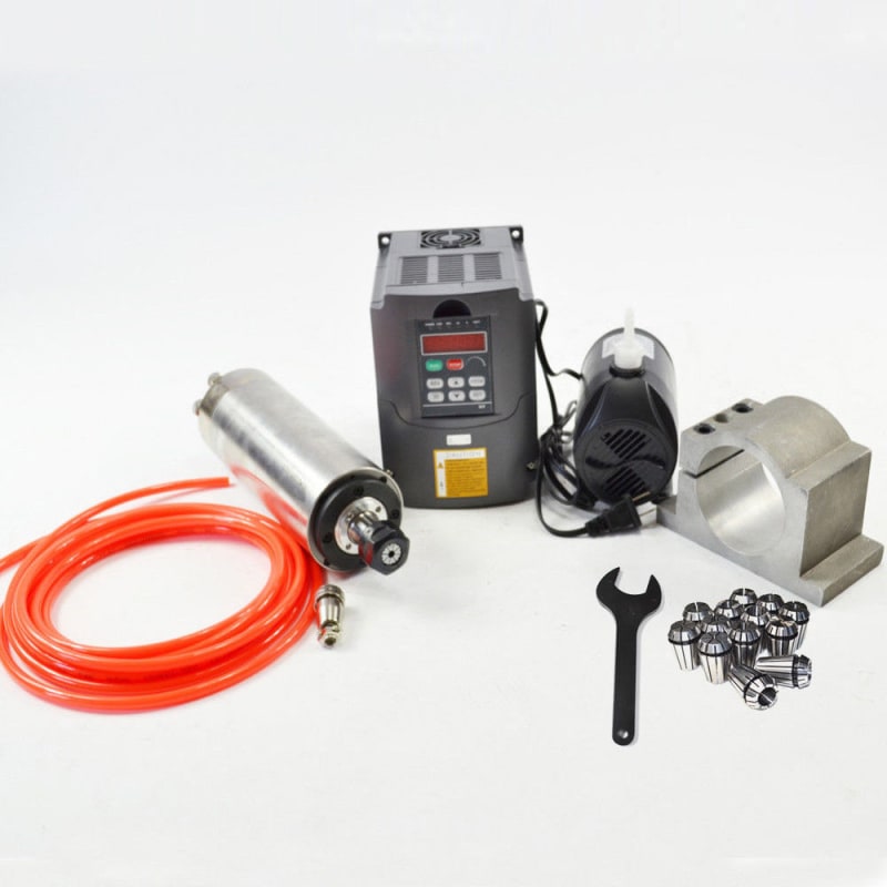

E-Bay
WATER-COOLED-SPINDLE-MOTOR-ER20-2.2KW-SPINDLE-amp-2.2KW-DRIVE-INVERTER-VFD-HY
$319.90
Have one to sell? Sell now - Have one to sell?
Details about WATER COOLED SPINDLE MOTOR ER20 2.2KW SPINDLE & 2.2KW DRIVE INVERTER VFD HY
input voltage:220V±15%(we also stock1.5KW,3KW,4KW,5.5KW,7.5KW inverter,pls contact with us if you need)
Output voltage:220V±15%(Analogous to Input voltage)
Input Frequency:48-63HZ
Output Frequency:0-400HZ
Input Phase:Suit for 1 phase input and 3 Phase input.
Output:3 Phase
Warranty:two years
From a well-know manufactory who manufacture inverter for close to 20 years

HY (aka HuanYang)... WORST DRIVE EVER!
For that price, use the motor and buy a decent drive.
Unless the motor is the same quality as the drive.
