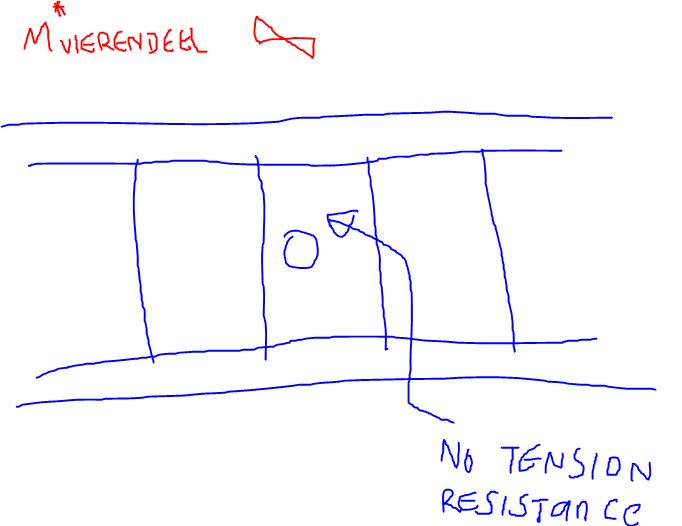

I understand the traditional method is that there is a vierendeel moment induced over the span of the opening which equals to (V*top/bot) x (Opening Length) / 2. But inside an existing beam you would not have longitudinal reinforcement directly above or below the opening and you won't be able to put it in obviously. So theoretically speaking, there isn't anything to resist that vierendeel moment (regardless of how small the penetration is)
So theoretically speaking, even a 5mm diameter hole cannot be allowed in a 1000mm deep beam. So what is the reasoning why this isn't the case?

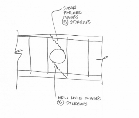

The reasoning being for larger holes requiring more thought and specific design checks is you can get the following type of failure which is often reinforced for in a new beam via additional smaller stirrups above and below with additional longitudinal reinforcement just above and below the opening, or via diagonal reinforcement going under and above the hole. But in an existing beam you can see how you can get a failure plane that doesn't intersect any of the shear reinforcement, which means you effectively can end up with a section that is unreinforced for shear.

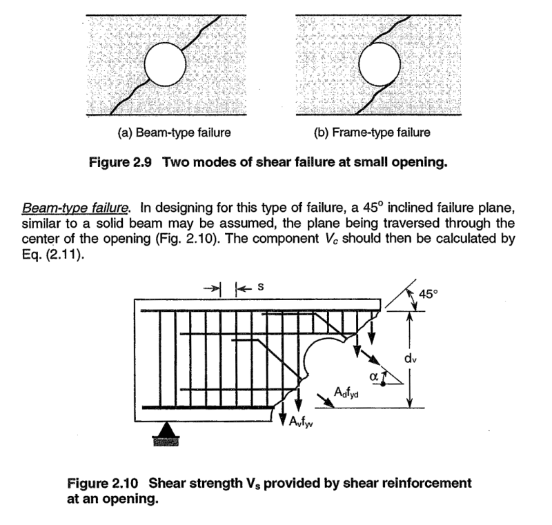

Tom, most codes I'm aware of require the designer to consider the secondary moments across the opening and may therefore require additional longitudinal reinforcement adjacent to the opening to both anchor any additional stirrups above/below the opening and to deal with the vierendeel moment. As shown in my sketch, the critical cross section can have zero shear reinforcement being engaged, so its important to check what type of failure might occur (see screenshot below for the two possible types, beam and frame type failures).
For some configurations, an alternative means is to demonstrate that there is a strut and tie arrangement that is capable of sustaining the shear across the opening. For example if in my sketch the beam was much deeper, then even with the assumed location of the shear plane you can hopefully cross at least 1 to 2 stirrup sets either side of the opening for a beam type failure like shown below. In that case you can probably demonstrate that it works if no forces were required to pass through where the hole is. Really depends on the geometry/hole size I guess.
Following shows this concept and the two type of failures that need consideration (from Concrete Beams With Openings - Analysis & Design - Mansur, Tan (1st Edition - 1999))

But it's the secondary/vierendeel moment part that I can't get my head around. This is key component that I'm not getting out of literature..
