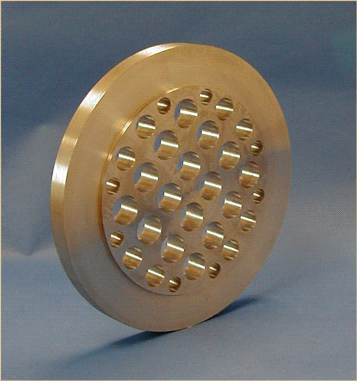

If you're really concerned you can always add a flow straightener or disc up stream.
that flow straightener looks like it would eat up a good chunk of head.
They don't. 1 or 2 psi nax.
I will also recommend following MMS SP-92 spec unless you have a specific case and a a very good reason why you can't. The overall distance will depend on the pipe diameter which you have not stated.
Putting in a flow straightener, if the only reason you are using it is to save space.seems like not much gain in overall shortening is going to happen. [ponder] there's usually a couple of flanges that go with it.
