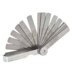

3 US bux.
A variety of thicknesses, since you have not said what spring rate, maximum force and maximum deflection you require.
Trim-able with good quality snips.
When you determine the thickness you need, the leafs/blades are avalable individually.
If the stress at max deflection is not too high, mild steel would work too.
