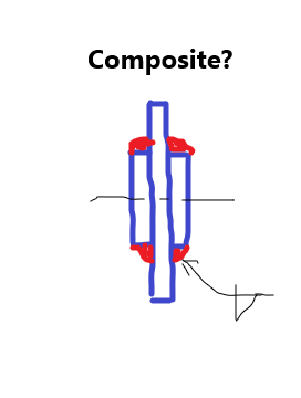

Hi All,
I have come across a situation where channels are welded to the web of the wide flange to reinforce the existing beam. This detail is on existing drawings and its a building that was built in 1980's. The beam is a roof purlin supporting deck and snow. Seems like it was reinforced as it was over-stressed by 15%. Maybe beam was reinforced as shown below because of site condition. I cant say why exactly.
I am re-evaluating the capacity of the composite section and I need some inputs. All members are A36 steel. I am using ASIC 360-13th edition and seems like the sections are compact. I am using section F2 to evaluate the capacity and there is around 30% increase in capacity with channel reinforcement compared to W8X10 steel alone. Is using section F2 the correct way of doing it? Also how do I calculate the weld required between the channel and the wide flange? As the CG of channel and the composite section are at the same location the equation VQ/I goes to zero.

WARose - there is no shear flow in this configuration at those welds.
This is a classic case of simple deformational compatibility.
There IS shear flow in the web of the WF beam at the point of the welds, as there is for any beam that bends.
But the Q value for each channel is 0...thus there's no shear flow.
(The area of the channel - that which you are connecting, is located a distance of zero from the NA, thus Q = 0 and shear across the weld is zero.)
Look over WillisV's response in this thread (about half way down) thread507-168270
...where he states the same thing.

JAE is correct. Shear flow q must be continuous, unless the channels and the beam web can be glued together, which is not possible.
But it's not for the upper part of that beam. If the 3 pieces are going to act together (with a combined "I")....there will have to be shear flow.
Yes - the shear "flow" is all vertical. Not horizontal.

The channel web and the beam web, though in contact, are two separate surfaces, thus represent a discontinuity that the shear flow in beam web cannot jumped over the channel web.
I might add that if the channels were offset from the NA just a bit, then there would be horizontal shear.

I don't think that's the key. The question is the 3 plates built-up shown below composite or not? If yes, shear flow is present, as the flow path is from the middle plate through welds to the side plates, the flow paths are all continuous. If not, then shear flow is only present in the middle plate, shear flow at the side plates are zero due to discontinuity.

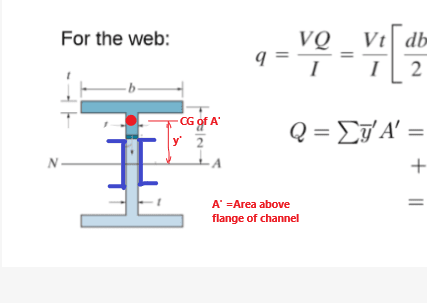

Under this situation, a designer shall ensure the continuous flow path by weld the channels to the beam web, then assume full composite action exists. The strength of each weld, fw, is equal to V*(A'*y')/Ic, which is shear flow intensity at the beam web - channel flange junction. Parameters A', y' are as shown on the graph below, and Ic is the composite moment of inertia calculated by SRE.
Note, after sizing the weld, it shall be double checked by strength requirement, fw ≥ √(fa2+fv2+fb2).
