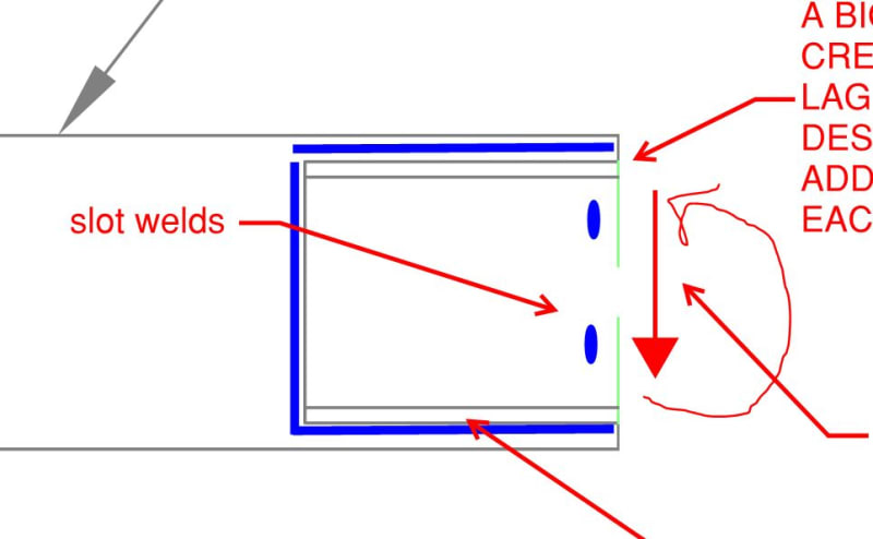

And just some detailing concepts because this stuff's super fun to talk / think about.

I designed the weld like you have shown above, I actually used Blodgett's book, it's old but it has served me well for a long time.
My question is more about what moment should I use to design to.
I have the moment and shear diagrams for this beam but I basically just want this to be as strong as an unspliced beam.
I used the 3 sided weld applying half of the allowable moment for the shape. Using the idea that half the moment will go into each side.
I believe this overkill but they need a fix, I need to work on other things.
Using Retrograde's check I needed roughly 8 1/4" length, checking the weld, I needed about 18" for 1/4" weld.
thanks

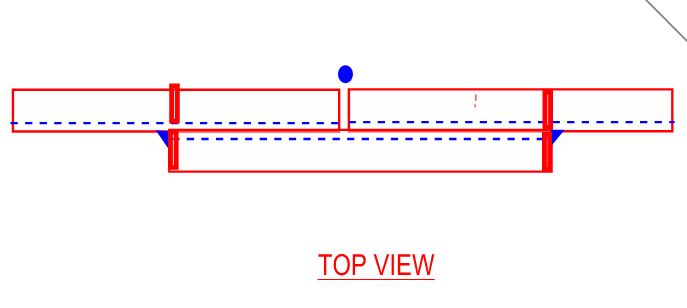

KootK,
I cannot brace it from the MC10 side.
The toe side of the C12 is braced at the center (where the splice is) and bolted to a channel above it at 6" increments.

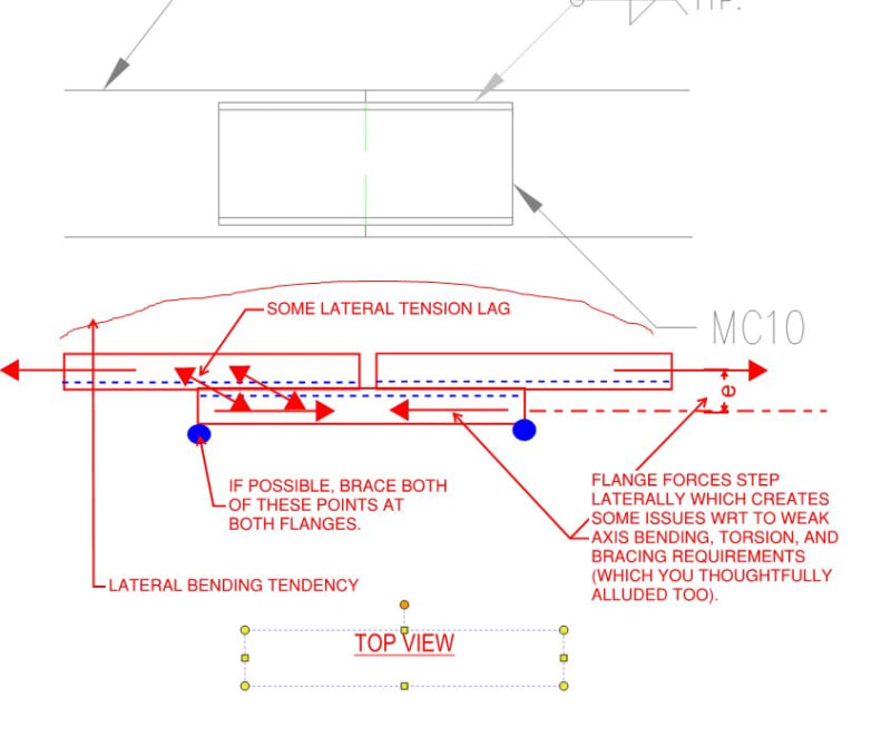

Retrograde's proposal to effectively develop the yield strength of the flange will be prudent then. Your design connection moment would be roughly the material yield stress times the plastic section modulus of the channel being spliced.

18" sounds altogether reasonable to me. My gut check minimum would have been 1.5 x the member depth which, handily, works out to exactly that. Of course, if you need to double your moment now, this dimension is likely to grow.

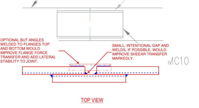

Another concept that I like to make the joint more efficient if you need it.

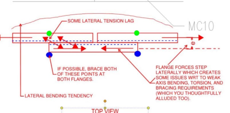

Green dots? Given what we're doing here, I like the idea of being able to form a moment couple with the braces in order to counter some of the natural eccentricity in the joint.
You mentioned end plates on the splice piece at one point. Set up correctly, I can see some logic in that now. It would kind of create nominal, weak axis moment connections between the splice and the main members and make a single brace point more robust.
