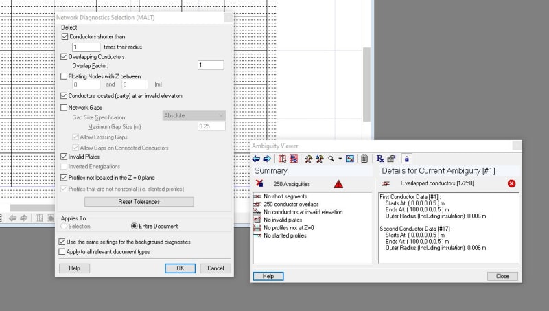

Hi everyone,
I am learning CDEGS recently, I found out "there are defects in the grounding grid during simulation, Use the diagnostic tool for more information.
Does any body experience this problem?
Thank in advance!!
Did you use SES-CAD? From SES-CAD, you can do network diagnostics to find out where the problem is.
Hi jghrist,
I appreciated for your reply.
I did network diagnostic as per your comment. It show up as attached.
It looks like you have many conductors entered twice. Conductor #1 is in the same location as Conductor #2. You will have to go through and fix each one. Probably delete redundant conductors.
Hi jghrist,
I do not know how to thank you.
Everything was OK now since your comments.
